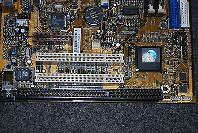

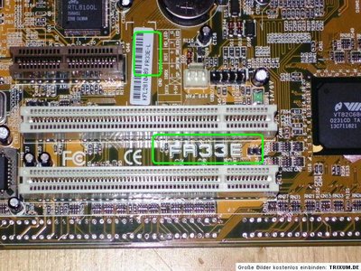

FR33E / FR33E-L are the exact same PCB board. FIC doesn't even list them separately. Same BIOS and Manual.
http://www.fic.com.tw/support/motherboard/mot … rboard_all.aspx
ftp://ftp.fic.com.tw/motherboard/manual/socket370/
But when you have one each in front of you they are marked differently on the board sticker. (The "L" or not.)
What is says on the sticker is often (usually in this case) what it will say online as to the model number so it matters to people searching for one.
ISA, Sound and LAN were all ~individual~ options so they were shipped in many different configurations.
These saw a lot of use in data center control/maintenance consoles and the data centers could order the options they wanted.
140.64 KiB
1759 views
FR33E-L - No ISA
49.05 KiB
1759 views
FR33E-L - With ISA
People (like me) are hoarding the ones with ISA so they are very hard to find now.

ISA, Sound and LAN were all ~individual~ options so they were shipped in many different configurations. These saw a lot of use i […]
I wonder if there is any auxiliary circuitry missing... if not just soldering an ISA slot in one of those boards might be enough. This would make that board an interesting choise, as the variants without the slot might be more common/cheaper. I'll add a footnote saying "This board doesn't always come with the slot soldered on". Probably more informative than just saying it might not have the slot.
Long time ago I thought about trying that but never did.
There are a slew of SMD parts along the ISA slot footprint .
IIRC mine are populated but I don't know if they all are.
We are remodeling and a lot of my stuff is in storage so I can't just go look.
Reply 106 of 119, by Tetrium
I'd think the fastest way to find out would be to visually compare both versions of the board and see if they are identical, except for the missing ISA slot plastic thingy.
It was often worth it to make a single design and sell 2 versions of it, one with some components missing, than it was to design and manufacture a second different board with just the ISA slot and perhaps some traces missing.
