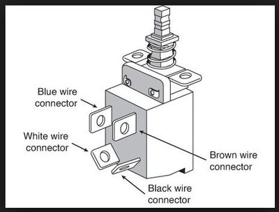

So I got this 486 PC but somehow power doesn't turn on. I think it must be related with power switch and I disconnected all wires.
Initial status was like this.
566D15783A0AA0000E
And then..
566D15C33514F7000A
566D15C635079A0017
The diagram on PSU is a bit confusing to me and I have no idea how to connect the wires. I mean which one is 2 and 3 when the switch shows P1 and P2?
If you guys can tell me how to connect the wires, it would be great. Please help me! Thank you.

The drawing on that PSU is showing a switch with 6 terminals (two being not connected) and the switch you show is more standard and only has 4 terminals.
The black and white wires are usually to AC with Black = Hot and White = Neutral.
(Looking at the drawing on the PSU) They want you connect it such that when the switch is shut the Black wire is connected to Brown and the White wire is connected to Blue.
- That at least is a common configuration and color codes. I found a photo.
29.74 KiB
148 views
Now, looking at your photo you have white and Blue reversed - but it should still work that way.
You may have a bum switch or a bum PSU.
