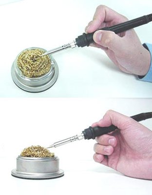

Reply 47 of 47, by PCBONEZ
A lot of people like these things (in addition to the sponge) for keeping the tip clean.
Some of them need fastened down to a board or something so they don't move around on you.
