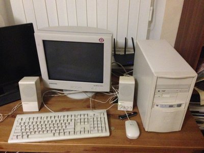

I finally got my hands on my first machine with a Pentium. Basically, all I wanted was to get something so I could get my hands dirty and not build a computer from scratch. This machine is extremely clean (the insides are actually much cleaner than my regular PC, 🤣), nicely built, not too noisy, and the screen works really nice.
Goals
A versatile and fast machine mostly for late DOS games.
1.35 MiB
1019 views
Specs
No name Baby AT case. For the life of me I can't find the model, but it's absolutely the same case I had as a child, though I don't remember what the specs were in that machine.
Pentium MMX 233
32 MB RAM, single DIMM
LuckyStar 5ITX1 rev 2.0 motherboard (Intel 430TX chipset)
S3 Virge 325 GPU with no added RAM
Cirrus Logic CrystalClear 4235-KQ
Quantum Fireball 2.5a 2,5 GB HDD
Samsung SyncMaster 755DFX 17" CRT screen
Genius EasyMouse
"Turbotrak Keyboard" or something
Creative SBS20 speakers
Notes
The biggest test of my character came when I had to choose between two CRT screens, this Samsung 755DFX and the Panasonic PF50 something. In other words, a flat 17 inch flat and a 15 inch non-flat model. Originally I wanted a 15 inch curved model so that I could have a "more authentic look and feel" and also could save some space. Turns out that 1) an older 15 incher needs about the same space a newer 17 incher does. 2) I only looked at the 15 incher for 10 seconds and my eyes began to actually hurt because the flicker was too noticeable. Long story short, I gave up on the idea of a "more time appropriate" screen and picked a newer model.
Next steps — comments welcome
1) upgrade 32 MB. Probably just get a 64 MB DIMM module
2) replace CD-ROM for a CD-RW — what kind of connections/standards should I look out for? Would any IDE model work?
3) get two Voodoo 2 cards. I'm not entirely sure what kind of games would I use SLI for, but I'm going to a shop that supposedly has "60 identical 12 meg Voodoo 2 1000 cards", so I might as well pick a pair, an FDD cable, a VGA passthrough and make an SLI
4) get a NIC card from the Vogons' Wiki article.
5) get a Sound Blaster AWE64 card. I don't know whether or not I'll go the whole MT-32 route, and for some reason AWE32 cards are 3 times as expensive at best.
6) get a new 40GB Seagate ST340014A or a Western Digital WD400BB IDE hard drive, since they cost the same and can be bought at the same place. Will they work? I don't know whether my mobo has an LBA-enabled BIOS update, so I don't plan for a bigger hard drive yet.
7) eventually get an S3 Trio64 card as soon as I get a nice deal for a fully upgraded model. turns out I have a faster card.

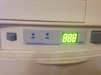

1) Turbo LED. It works, but it shows 888 instead of the actual frequency.
1.56 MiB
1017 views
How can I make it work properly?

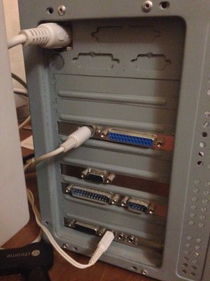

2) I/O
Here is how it looks right now
1.36 MiB
1017 views
All COM, LPT, PS/2 connectors seem to be placed on separate boards that are honestly made from tinfoil and flex considerably. I'll have to replace them really soon and I'm wondering — can I place those connectors in the holes that are currently sealed? You can see them above the board slots. Looks like there is a hole for a COM port, a second PS/2 port, an LPT — everything. What kind of hardware do I need for that?

Reply 1 of 45, by JayCeeBee64
Rank Retired
Retired
Nice find! Looks very clean and tidy. Any inside pics? 😀
Most late DOS games should work great with it. A few might have the well known Borland Runtime Error 200 issue but it can be solved with a patch or TSR. Having the PS2 mouse connector is a plus IMO.
As for your upgrades/questions:
Upgrading system memory to 64mb will mostly benefit Windows; no DOS game that I know will use that much.
An IDE CD-RW will work nicely (that's what I have on my Socket 7 PC).
A Voodoo 2 SLI setup will be held back by a P233MMX; you most likely need a P2 450 or better to see them truly perform. A Voodoo 1 would be a much better choice here.
Any particular reason why you want to replace the Cirrus Logic sound card with an AWE64?
Only way to find out if a 40gb HDD will work is to try one out.
LED displays usually have jumpers in back to set the numbers. You'll have to play with them to change the display to what you want.
Sounds like the backplates with the I/O ports are not well secured, in which case you can punch out the case holes, unscrew the connector nuts with a hex socket or hand wrench, then screw them back in the corresponding holes. The PS2 hole will probably need to be drilled at the sides so you can screw in the connector securely (this one needs a Phillips screwdriver).
Since this PC came with Win98SE I say keep it. Windows 98 is a better match for this PC, also has improved USB support if you decide to eventually use it.
Looks like the PC speakers you have are the shielded type so I don't think you have anything to worry about. If the CRT has funny colors at the corners or screen geometry starts to change unexpectedly then move them farther to the sides as much as you can.

For the LED, then look inside the case, behind the led-panel. There should be jumpers. Just play with them. 😉

The Russian site that you gave a link to, states that the board has two USB ports. Maybe it is optional, but you might find that you have the headers on the board already.
Edit: I found this:
http://bios.rom.by/LS/5I-TX1/
Check your board for a 9-10 pin connector between 1st and 2nd PCI slots, near the edge of the board. The same site also mentions with original BIOS your board supports HDDs of 32GB max. It also says there is a modified BIOS that supports HDDS of 120GB size. So, I'm sure your proposed 40GB drives will work on your machine, providing that if you will jumper them to limit their capacity to 32 GB (virtually all 40GB HDDs have that jumper).
There is also this for USB header pinout:
