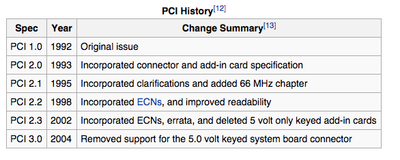

i had really screwey things happen with those cards i had two and i kept getting confused as to which was good + which was bad. becuase they kept giving different results!!!! it might have something to do with pci spec? ie: pci spec 2.0 vs 2.1?
https://en.wikipedia.org/wiki/Conventional_PCI
check this chart for the times of pci spec revisions
pci 2.1 was around 1995.. maybe your board is 2.1 and the 3com card is 2.0 only
