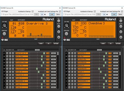

If someone does not care about SC-VA authentic/traditional look but prefers readability the font that is responsible for the less than perfect look is 'ODRF_UPR-Regular.otf'. If you uninstall this font SC-VA uses Windows default Segoe UI that makes characters more readable (Notice that with original font the character '3' regularly looks like '9' in the channel list).
Before/After:
271 KiB
2886 views
