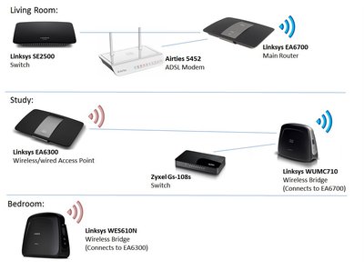

According to my limited experience, there are routers (sometimes even cheap ones) with every option available (works as a router, or wireless bridge, or wired bridge, or access point) and there are routers, sometimes even expensive ones, that can only do the router thing and nothing else.
Here is my setup:
118.59 KiB
652 views
As you can see, the second router is setup as a wired/wireless access point and a wired bridge. But it is not possible to set it up as a wireless bridge.
The modem/router that at the moment I use as a lean modem, a popular local brand called Airties, can do everything, including wireless bridge mode (my previous setup had a similar Airties instead of WUMC710, as a wireless bridge).
