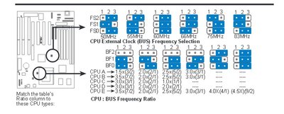

computergeek92 wrote:
What I meant was: What are the settings for other K6 speeds? If 400mhz K6-2 is 2x mobo, 6x translated, what about for a k6-2 333 for a 66mhz Socket 7 board? Any info on other speeds? I was thinking on trying a 333 for an upgraded Win95 machine plan.
What you are asking is motherboard dependent and you should look in your manual at the tables like these.
68.15 KiB
331 views
95.13 KiB
331 views
That's from a manual for a 430TX board.
Hope that helps.
