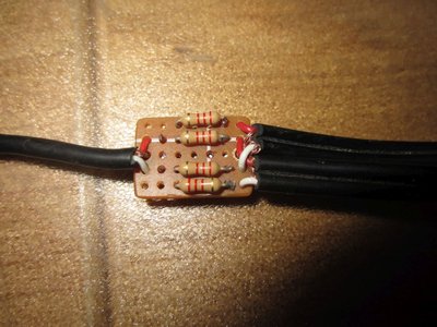

AFAIK the lower the resistance for the mixer, the less sensitive to noise it will be, but the load on the outputs will be lower. I used 10kOhm resistors in my mixer, which is a bit noisier than I'd like but useable, but I've seen projects around the internet using 1kOhm resistors. Also, if all your cards have amplified outputs, they can probably handle lower impedances better. But for two cards on the same computer running a P2-P2 cable from the PCI card's line out to the ISA's line in (and unmuting the line in in the card's mixer) works well.
I think I'll try the passive mixer, as that'll let me deactivate the AWE64 in Windows. If it doesn't work well enough, I'll go with the other suggestion. Putting together that mixer won't take long at all, doesn't really matter if it turns out to be for nothing 😀
The AWE64 doesn't have an amplified output. However, I think it's better to use the line out signal in any case, as line levels and related impedances are somewhat standardized if I've understood it right.

Doesn't it have a green "Line Out" and a black "Speaker Out"? At least I think my AWE64 Value has (its stored now and I'm about to get out of the house), and the speaker out is amplified. That being said, its a bit hit and miss: I have sound cards that work perfectly when the Line Out is connected to the mixer and other that behave in weird ways... I have one ESS card that seems to lose all bass when I plug the line out to the mixer, but sounds fine with the speaker out, and anoter card (Aztech? can't really remember which card) that works fine if I set the volume in the mixer up to ~70%, but if I raise a singe notch above a certain level it all becomes a buzzing noise... and, once again, everything works well if I plug the amplified output instead.

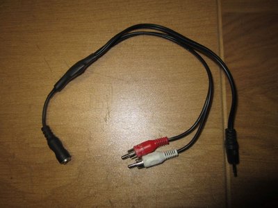

Nope, the Awe64 Gold only has one output, a line out one with RCA connectors. No amplified speaker out. The 3.5mm jacks are line in and mic in. Here's how it looks.
Put together a passive mixer now anyways, went with 2k2 ohm resistors. Testing it tomorrow, time for some sleep now 😀

The passive mixer cable works like a charm, at least my untrained ears can't hear any distortion. Had to knock up the active speaker's volume a bit, but that is of course as expected when introducing additional impedance between source and load.
