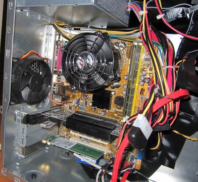

Reply 42 of 80, by SW-SSG
One of my systems has an Asus P5SD2-VM:
471.75 KiB
2075 views
It's AFAICT the only consumer motherboard released with the last PC chipset that SiS put out, the 672. (The AMD counterpart 771/772 does not appear to have made it to market.) It's very much low-budget for 2007-2008, and drivers are not available for OSes older than Win2K, but it's very stable (granted it's running only an E2180 at stock, 2GB of 667MHz memory, an HD 4350, and Win7 32-bit) and goes OK. It's nice that the last chipset they put out is very usable, even if it's not especially interesting or high-performance.

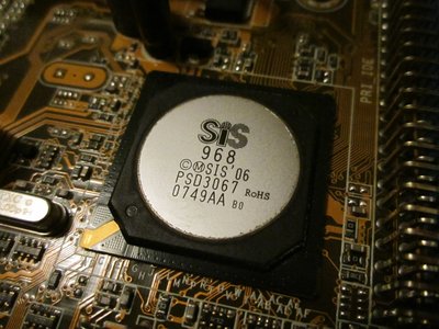

448.81 KiB
2075 views
Southbridge

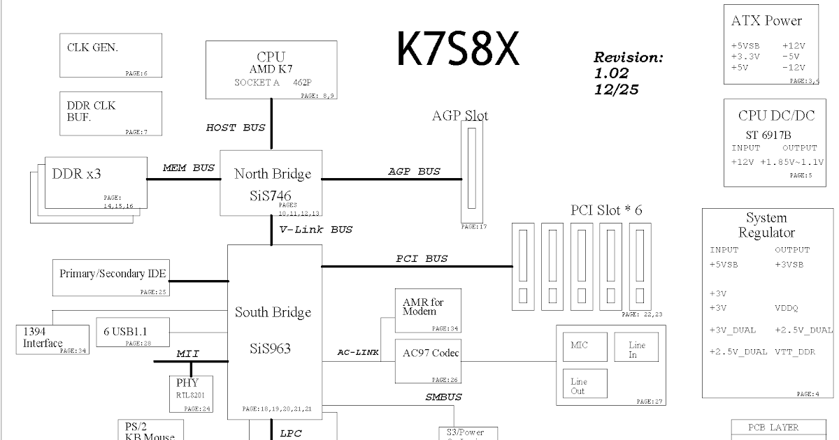

Carlos S. M. wrote:
... SiS 746 ...
See: ASRock K7S8X and K7S8X R3.0.
There is a (leaked?) schematic here that suggests the K7S8X drives the CPU VRM using +12v, but I don't know if this is true. The board certainly doesn't have a ATX12V connector...
