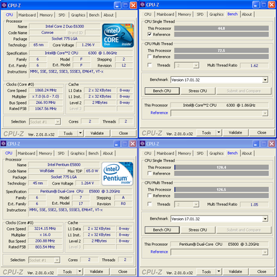

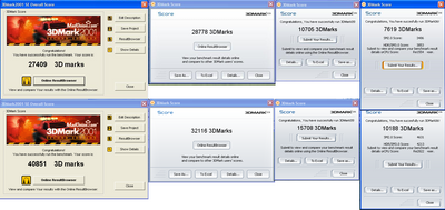

CPU upgrade was a success! Couple benchmarks before versus after below in pictures with top row e6300 and bottom e5800. 3Dmark 2001, 05 and 06 had a huge gain in going from e6300 @ 1.793ghz stock to e5800 3.214ghz. Memory was bios defaults 533mhz. GPU was G92 Asus 8800GTS.
I seriously cannot recommend having e6300 with this motherboard. It can't even clock stock 1.868ghz which CPU-Z reports incorrectly. Motherboard tops out at 256 FSB which is actually 1.793ghz. I am not sure what is up with CPU-Z Benching going from 44 to 120 points single core. Almost 300% increase can't be right unless there is some instructions missing from e6300 which the benchmark uses.
I am not quite happy with results compared to other systems with 8800 GTS I have set up. Probably need to test a few older driver versions since I'm running last 332.21 WHQL for 32bit XP "SP4" drivers right now.

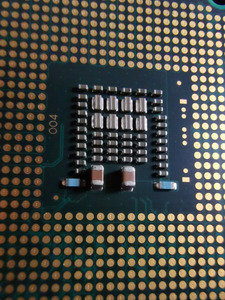

BTW, does all ceramic caps are in place on CPU?

Reply 571 of 623, by RETROKOMODO
Here's a close up on the CPU
922.07 KiB
384 views
793.22 KiB
384 views
Looking good

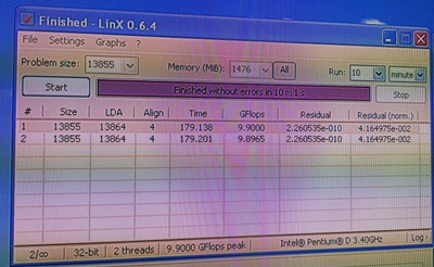

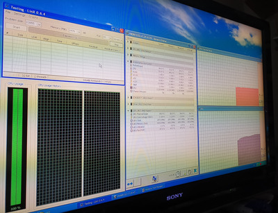

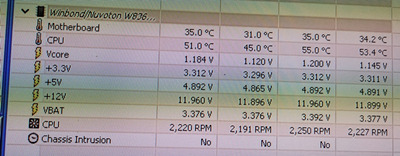

Just following the guide on https://obsproject.com/forum/threads/how-to-t … with-linx.5361/ as never used it before. Should have a result soon.
1.7 MiB
318 views
Reply 576 of 623, by RETROKOMODO
Well after a 10 min LinX session all looks good?

Reply 577 of 623, by The Serpent Rider
I would test it at least for one hour. Although it will certainly boot with Core 2.
Reply 578 of 623, by RETROKOMODO
The Serpent Rider wrote on 2022-09-07, 17:26:
Now testing for 75 mins cos you know - the price of electricity at the moment.. 🙁 I'm assuming the reason for this exercise is to stress the VRM's to make sure the board can cope with high power draw over a sustained period?
But once tested to completion, this would be the correct CPU to go with in your opinion? download/file.php?id=144794&mode=view and I should be safe to switch bios and change to it?
