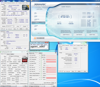

Reply 10 of 652, by agent_x007
I own both 775Dual-VSTA, and 4CoreDual-SATA2 R2.0 boards.
Beta BIOS will "broke" Pentium 4 EE Gallatin support on former board.
Here's video that confirms "Gallatin" support on it : https://www.youtube.com/watch?v=wdz-q2YErTI (kinda old, but it's still amusing 😀)

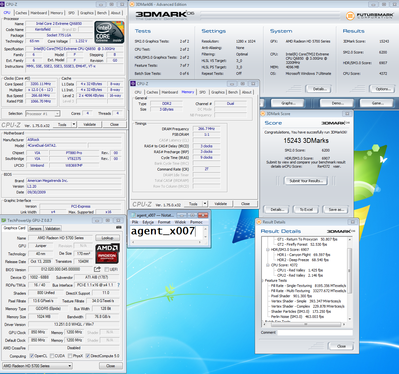

Few benchamarks with QX6850 (highest CPU 4CoreDual-SATA2 supports from 65nm, I heard it can work with Yorkfield, but it isn't stable with it - VRM section isn't good enough) :
Radeon 5770 1GB (highest performance that's still OK on PCI-e 1.0 x4) :
3DMark06 :
524.59 KiB
17882 views
3DMark Vantage (P) :
948.14 KiB
17882 views

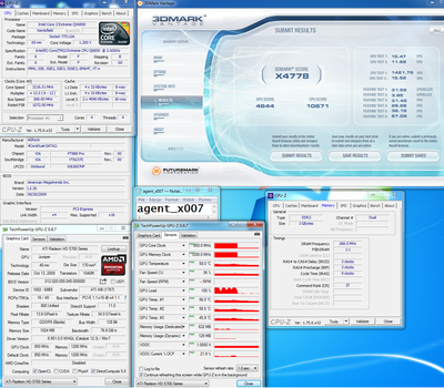

3DMark Vantage (X) :
919.83 KiB
17882 views

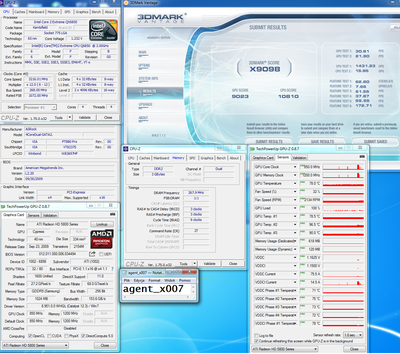

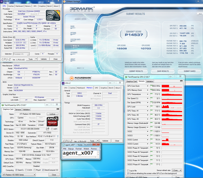

Radeon 5870 (ref.) - Overkill, and limited in lower detail level by PCI-e x4 :
880.37 KiB
17882 views
864.33 KiB
17882 views
CPU was overclocked with stock Intel cooler (standard height).
CL timing = "4" in all tests (CPU-z can't detect DDR2 memory installed for some bizzare reason).
Vdroop and Load Line Calibration does not exist on this board.
Vcore can drop to 1,136V with QX6850 I was using.
Good thing about this ?
Low Vcore = Low CPU temps 😀
PS. This boards DOES NOT support Kepler GK110.
I checked both boards with GTX 780 Ti I own, and they will not POST (regardless of BIOS/CPU used).
It will support GT 440 GDDR5 with no additional PCI-e plug (checked, can upload screens if needed).

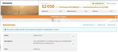

I had the board volt modded and also my HD3850 AGP. It gave up the ghost eventually, or only randomly started up. It had a weird issue
related to the onboard sound in COD4 only, in that it would throw you back to the desktop regularly, never fixed that but other games were fine.
Here's my 3dmark 06 result I got with it.
    76.97 KiB
    17659 views

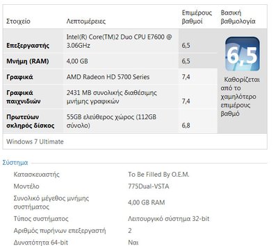

sorry for the old thread revive i have with this motherboard Asrock 775Dual VSTA and i installed bios 3.19a
i use the ati hd5770 and it runs great and also an ssd that made the system really smooth
for processor an e7600 3.06ghz i have windows 10 but when i had win7 this was my rating
ram is 3.3gb not 4gb, also i heard you can installed a xeon 5410(with mod ofc) and it works as quad but it
wont be at 2.33ghz probably less that 2.0 due to 1333fsb of the cpu.
