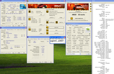

http://valid.x86.fr/ij08g9

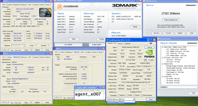

7900 GS AGP 3DMark 01 SE score @ 3,74GHz 😀
778.03 KiB
2609 views

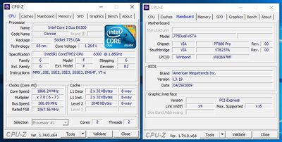

Posting this from a 775Dual-VSTA board, updated to the latest modified BIOS from that german site and happily running a Core2Duo E6300 @ 1.8GHz and Windows 10! Indeed, it needs the PCI Express fix mentioned in the first thread. Doesn't seem to particularly like "fast boot". Another issue that had me baffled was that at some point after an update, it started this weird behavior: once in a while I'd switch it on and it would show the Windows logo, then display a light blue screen stating "Resuming from Hibernation" and afterwards power off instantly 🤣 The fix was this one (execute in command prompt run as admin):
powercfg /hibernate off
143.27 KiB
2568 views

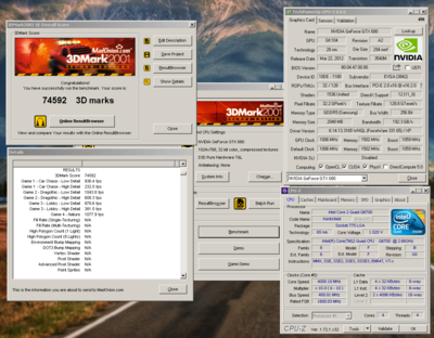

How much does your setup score in 3DMark01? It would be interesting to see how much of a difference the chipset makes. My Q6700 @ 4GHz on P45 scores 74592. Keep in mind that 65nm @ 4GHz should be roughly equal to 45nm at 3.84GHz. So if there's any difference in our scores, it's probably caused by the chipset.
Q6700 4GHz, Asus P5Q3, GTX 680, XP-SP3:
630.17 KiB
2466 views

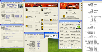

3DMark 01 SE :
GTX 580 (850/4400) : 61811 pkt.
419.06 KiB
2440 views

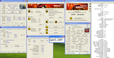

Radeon HD 5870 (850/4800) : 61317 pkt.
430.59 KiB
2440 views

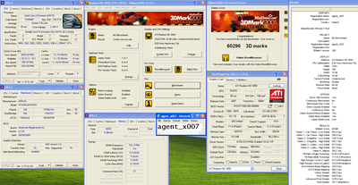

Radeon HD 3850 AGP (715/1818) : 60296 pkt.
439.39 KiB
2440 views
Few things to keep in mind :
1) A GTX 580 OC (+10%), isn't exacly a GTX 680 😉
2) I use PCI-e x4 slot (or 1/8th of x16 2.0 bandwidth),
3) Your FSB is over 50% higher than mine (256MHz vs. 400MHz [effective : 1024MHz vs. 1600MHz]),
4) I assume your RAM frequency is over 2,3x higher (682MHz vs. 1600MHz [DDR2 vs. DDR3]),
5) The only tests in which GTX 680 is significantly faster than GTX 580 is Nature test (over 2x faster), and my setup is actually faster in Lobby "High" which is interesting to say the least 😀

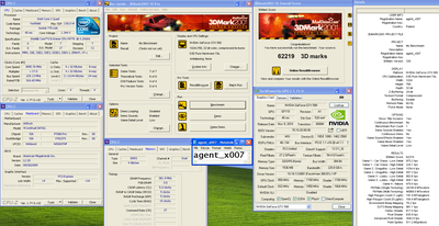

I did get however a higher overall score in that last case 😁
Probably because of a little higher CPU clock.
Also CPU-z "gave up" naming a Yorkfield type CPU model with x17 multiplier... interesting 😀
62219 pkt.
428.92 KiB
2369 views
