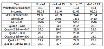

Sorry for the necroposting, I did some tests with 4in1 while using tmc ti5vg+ that use the old good Via MPV3 chipset, those are my results with a k6-350 and windows 98 se:
I also tested v4.35 but results are slower, I consider the 4.26 globally the best version for mvp3, unlucky not every 4in1 version is still findable.

Oh those are really old. I use 4.35 for MVP3 and 4.43 for Apollo Pro. Can you upload 4.26 here?

Thanks. Saved it for future testing.
Not exactly a night and day difference between 4.26 and 4.33 though. Makes me wonder what changes were made between these revisions.

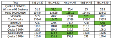

After the mvp3 round up, I tested my QDI Advance 10T (Via Apollo pro 133T) with some 4in1 drivers. The rest of the system is: Pentium 3 866, 512mb pc133 cl2, geforce4 ti4200 (I wanted a cpu limit condition), windows 98 SE.
I tested 4in1 from v4.32 (the version used at the time on reviews), v4.43, v4.45, v4.46, v4.49, v4.51. For version 4.32 the agp has been installed on turbo mode. After every release test, 4in1 has been disinstalled from it's installer, results on q2 (opengl) are pratically the same at 640 and 1024

Very suttle differences. Do some of these driver versions use AGP fast write and sidebanding?

Well to be honest i'm sure that the first version if installed in turbo mode enables fastwrite, but from v4.43, the option is gone, you can just choose if install the agp drivers or not.
