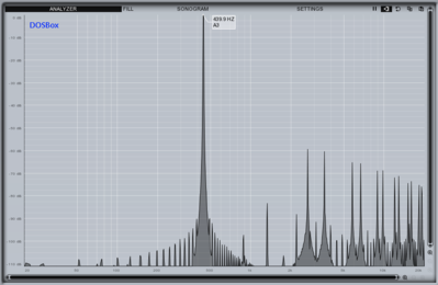

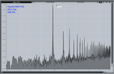

Using the OPL440 soft (attached) by a user called NewRisingSun to play a pure 440Hz sinewave using the OPL chip:
*I used high FFT number for maximum accuracy.
71.49 KiB
2900 views
94.05 KiB
2900 views
I have been a musician and recording hobbyist all my life.
I am musically trained and have excellent relative pitch hearing, I can play any pop/rock song by ear on a guitar in a matter of seconds.
Yes I can hear a 1Hz difference but only with a pure sinewave in a direct comparison in my DAW with a signal generator and fast switching between the two.
Adding any harmonic distortion or impurity to the sinewave makes it several times harder to hear.
The chances an average person will hear any difference in pitch while sequentially listening to a complex music track with 1Hz pitch shift is slim to none.
This 1Hz deviation from 440hz with YMF719 is nothing to fuss about and probably within spec.
I wholeheartedly recommend the YMF71x cards.
* Anything that is not a double blind listening test is meaningless in the audio comparison world.
Claims like "I definitely can hear a 1hz pitch difference between two full compositions played in sequential order", is 100% biased and false.
The attached comparison files are 15 seconds of Duke Nukem 3D soundtrack with 1Hz deviation between them.
Try to do a double blind test, someone else switching between the songs while you being blindfolded with headphones and looking away.
Or you can use ABX plugin for Foobar2000: http://www.foobar2000.org/components/view/foo_abx
The whole audio community uses this plugin to test if they can hear difference between MP3/FLAC, 96000/44100, etc...
Most self proclaimed audiophiles fail miserably an ABX test and get a 50/50 result they are guessing... 😀

Here's a site you can calculate the difference in semitones between two frequencies:
http://users.utu.fi/jyrtuoma/speech/semitone.html
440 to 880 would be an octave or 12 semitones.
440 to 439 would be 0.039 semitones or less than half of a 1/10 of a semitone. 😀
You gotta be super-human to hear a difference in complex music with that imperceptible pitch shift.
