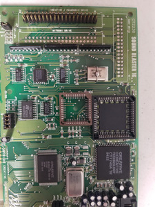

I dont think I can get a PLCC socket on mine. there are some close by resistors. (https://xn--krketr-jual.com/awe32.jpg)
the CT2760 has a similar issue, as did my CT2230, but you can just relieve the outside of the socket a little with a file to clearance for them
the resistors are so short you don't have to take off much

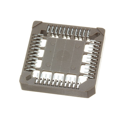

PLCC-44 for surface mount, i.e. SMD type and not with pins underneath.
Also, the bottom plastic needs to be easy to remove (otherwise you cannot solder it by hand), which is kind of hard to judge by the picture of the socket itself - I am making this note, because after using cheap non-branded PLCC sockets, I decided to go expensive and fancy with "3M" branded made one - it was build like a tank - very hard to remove the bottom, because of very hard high-quality plastic - even using very sharp cutting pliers managed to damage some of the metal contacts, because so much force needed to be applied to cut through such hard plastic.
last, but not least here is a good video how to solder by hand PLCC socket with removing the bottom:
https://www.youtube.com/watch?v=qI3jnfKCAsc

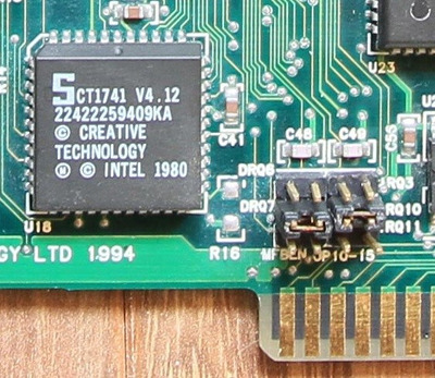

I presume the DSP chip is on different location on the PCB depending on the exact AWE32 model and thus I cannot speak for all models, but on mine CT2760 it's the following chip - CT1741 - it's also the only PLCC-44 packaged chip on the PCB and thus easy to locate just by that:
93.37 KiB
982 views
AWE32 CT2670 DSP
as you can see even the exact version "V4.12" is written on the chip. So, in my case will be double upgrade - not only to V4.13, but to bug-fixed V4.13 (big thanks to @Maelgrum). So, the steps are:
1. de-solder the original chip
2. install PLCC-44 socket
3. use external programmer to program new replacement chip with what is posted here
4. install that new chip from step 3.
Dont cut out the bottom, its there for a reason.
PLCC44 can be hand soldered with a curved tip.

S95Sedan wrote on 2023-09-26, 21:39:
I agree, it's needed to lift the chip to the correct level - after I cut it and solder the socket, i put it back - it stays between the PCB and the chip - that works for me. However, I will try your advice to use curved tip as well.

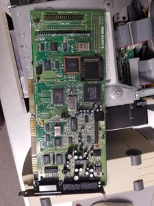

Reply 196 of 1053, by maxtherabbit
I used to refuse to cut the bottom, and yes it's possible to solder it that way, but eventually I just started cutting it because it makes the whole process much faster and there is a little hole in the PCB you can use to push the chip out after. I've had zero problems resulting from the chip being inserted "in too deep". Socket is made by mill-max from digikey
