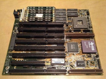

After being very quite of late, I came across another 386 motherboard that has VLB.
I recognise the chipset from a post on here a while back: -
Vogons post; - Help with IBM Mystery Machine
... a picture of that board: - http://i.imgur.com/Ak4ydlu.jpg
That system happened to have a surface mounted DLC3 Blue Lightning and an empty Socket 3.
Does anyone know of this chipset or had any experience with? I've read it may be a re-branded chip though i'm not too sure. The chipset code is the same as on the board I've just received which gets me wondering about 386 performance if it is intended for Socket 3 or 99MHz DLC. 😒
I've recently bought this board but can't find any info on it - manual/jumper settings... With most 386/486 combo boards you can fit the math copro in the 486 socket but at least there were markings on those boards. On this there is only a marking for 486 cpu and nothing about 387. I'd like to test the RapidCAD.
