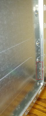

Reply 43 of 72, by clueless1
I'm dealing with an interesting problem with this build. The case I'm using seems to have a grounding issue. Intermittently, it won't POST when in the case (usually after some movement or add/removal of components), but whenever I remove the components and run it on the bench, it POSTS every time. 😀

Reply 45 of 72, by clueless1
Found the source of the grounding issue: the tabs where the expansion card slot covers are supposed to touch when inserted were not making contact. I just had to bend them back up a bit so when you insert expansion cards in, the bottom of the slot cover is in contact with them. Whew!

I was very tempted to move back to the black case after spending a couple of hours working out the grounding issue I was having with this beige one (it would go away when I ran the system on the bench, then come back when I assembled into the case). Really? I've never had such an issue until now. On the case, if you look on the opposite side of where the motherboard screws in,you will see little slits where the bottom of each expansion card comes through when you plug it into the board. There are little grounding tabs there that were bent to the point where they were making intermittent contact with the expansion card slot covers, which in turn would cause the system to not POST intermittently when I moved the system around a bit. Pushing those tabs up enough that they made solid contact fixed the problem.
Note the hard-to-see red rectangle outlining the problem area.

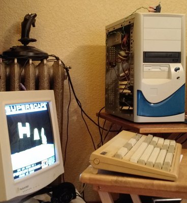

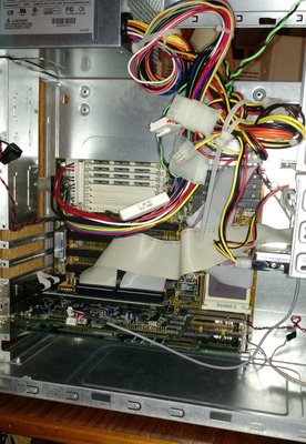

Anyway, some photos of its current state... (note the homage to a Vogoner who sold me an I/O card at a sane price)

Reply 48 of 72, by h-a-l-9000
Rank DOSBox Author
DOSBox Author
It's not a grounding problem - at the latest when you tighten the screw for the slot plate it makes contact with the case and thus is grounded. The metal down there is electrically same as the rest of the case.
You have cracked solder joints, broken traces, corroded contacts or something along these lines - the little force caused by the bent plates will put it back to operational state. This is no reliable fix though.
The mainboard or affected expansion card have to be considered trash unless you find and fix the cause.

Reply 49 of 72, by clueless1
Hmm. I'll keep an eye on it. But it's been working consistently since yesterday when I bent those tabs up, whereas it was failing regularly prior to that.
