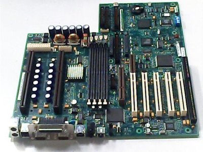

There are some cheap IBM Intellistation M Pro (03N2499) dual slot 1 motherboards out there. AGP, PCI and one ISA!

Avoid OEM boards at all costs imho. This was a time where they would use non-standard parts to screw with you.

Even for 20£ ? PSU for them are cheap if an standard cant be used.

I have one of those boards. In fact I just got it out to compare with the picture and it looks like an exact match. Mine came out of an old M Pro Type 6889 440BX workstation. I upgraded the owner's system while reusing the IBM case, so I just have the bare board now.
I wrote a longer post about it here:
IBM Intellistation M Pro 440BX dual slot-1 board (03N2499)
The motherboard and case are EATX and it uses an ATX power supply. The quality is excellent, but the main hassle with these boards (like most OEM boards) is that they have nonstandard front panel connections that you'd have to rig up some way of using.
Major limitation - the BIOS refuses to run with anything later than a Katmai. My board supported Coppermine voltages but when I tried using them, the BIOS displays an error message stating that the CPU is unsupported and refuses to boot any further. Maybe it's possible to hack the BIOS to get around that, but the chip is totally not replaceable so that would be a pretty dangerous thing to experiment with.
It's a very well built board but the front panel wiring issue is the main downside. Katmai limitation may suck depending how fast you want it to go.
