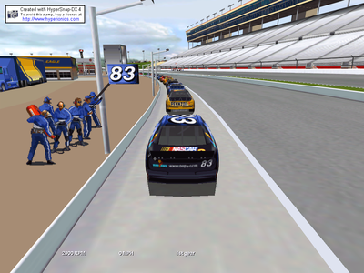

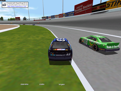

Here is a 3dfx glide game with Edge Anti Aliasing support. I have made some screenshots a while ago.
Nascar Racing 3 (not the maximum details were set because of the slow CPU)
on Voodoo3 1024x768
In this game:
When Edge-AA is off, some annoying edges still get anti aliasing (look at the fence).
When Edge-AA is on, some less annoying edges won't be anti aliased.
Screenshots best viewed in fullscreen mode.
Edge-AA is off.
531.59 KiB
730 views
Edge-AA is on.

Edge-AA is on.
