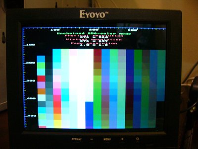

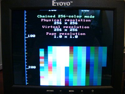

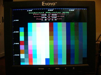

Here are my results from xjas' test suite.
Monitor: Eyoyo S801H
Native res: 1024x768
Scaling: ?
Aspect ratio: 4:3
Machine: SE440BX-2 / P3 450MHz / MS-DOS 7.1 (98SE)
Video card: Creative TNT2 Ultra 32MB AGP
Univbe: No
Tested by: boxpressed
OVERALL COMPATIBILITY RATING: 9.5 / 14
 Application          P   F   CP  Notes
| Ambience | | X | | |
| Luminati | | X | | |
| Timeless (56Hz) | X | | | |
| Timeless (60Hz) | X | | | |
| Dowhackado | | X | | Music but black screen |
| Kukoo2 | X | | | Monitor reports 54Hz |
| Copper | | X | | Fails to sync during wobble effects. |
| | | | | Passed about half of tests. |
| Sunflower | X | | | |
| Yo | X | | | |
| Impulse Tracker | X | | | |
| CubicPlayer 132x43 | X | | | |
| Tweak 256x256 | | | X | Top 15 px, bottom 1 px clipped |
| Tweak 360x480 | X | | | |
| Tweak 376x564 | X | | | |
| PAL-on-VGA | | X | | |
| NTSC-on-VGA | | X | | |
| Other notes: |

Actually this is a great score, up to par with CRT of that era.
In Ambience and Luminati you can lower and raise the refresh rate by pressing the Down and Up arrows, maybe the Eyoyo will sync to a slightly lower refresh rate because the test starts at 87Hz.
It does 720x400@70Hz and 640x480@60Hz properly that is all I need.
Question, are the white squares from your images actually clipped on screen or is it the camera over exposed?

Overexposed. Actually, there isn't a single white square on screen -- just a lot of very light shades of other colors.
Yes, I did try to use the arrows on Ambience and Luminati the first time. I went as far up and down as I could before the program would not register a different rate. Each time, the monitor showed "Not Support."

Neat! Yeah I've certainly seen worse LCDs (even ones aimed at VGA use.) We (I) should totally get that database up and running, threads lijke this are why. 😀
I'm disappointed the 256p mode doesn't work since that's an even multiple of (1024x)768. I wish ANY of the mfgrs would take the time to get this right. Hell if only it could accept 15kHz sync & 256p on the VGA port it would be the best tiny Amiga monitor ever. 😜 I wonder how hard it would be to write custom firmware for a screen like this...

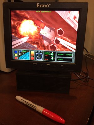

Reply 24 of 42, by boxpressed
The S801H fits nicely atop my Jawbone Jambox Mini. Sharpie there for scale.
Descent II on Rendition Verite looks and sounds great!

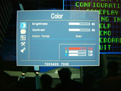

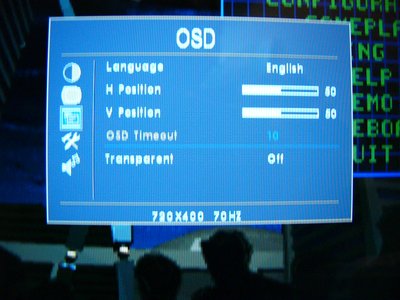

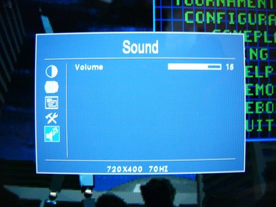

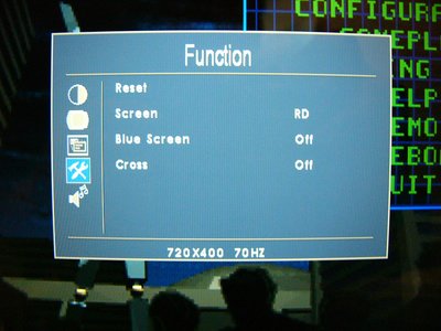

Reply 26 of 42, by boxpressed
Descent II (Verite hardware accelerated) runs at 640x480, what you see in the photo. Regular D2 runs at 800x600 in software rendering.
I forgot that I said that I would post photos of the menu. Here are three, and three more follow in the next post.
These three screens are pretty self-explanatory, except for perhaps the Function screen. The Screen function flips the image 180 degrees and/or shows the mirror image. (No portrait mode, however.) Blue Screen and Cross are for industrial application.

Reply 27 of 42, by boxpressed

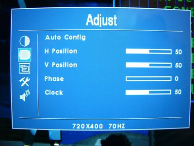

Here are three more screens.
There are three settings for color: 6500K (default), 9300K, and User. I think the default setting is a bit on the cool side, so I select User and bump up the red level (second screen).
The Adjust screen is probably what you're wondering about. The Auto Config is weird on my monitor. If the screen is a bit out of alignment, and you select Auto Config, it will center the screen nicely. However, the screen background will turn green. This may have to do with the Rendition Verite. But the Phase is also changed to 26. So, if you change the Phase back to 0 and turn the monitor off and on again, everything is normal and centered.

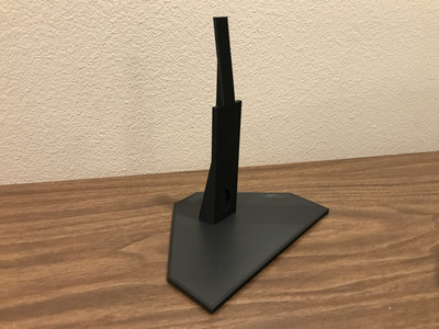

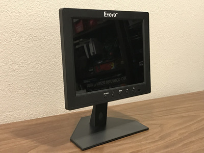

An update to my old thread on this great little monitor.
The only thing I disliked about it was its laughably short stand, which made plugging and unplugging the VGA cable a chore, not to mention how the low clearance meant that the VGA cord itself could tip the monitor.
I always meant to rig a new stand for it but never got around to it. Anyway, I was thrilled to discover that someone designed a stand for it that can be 3D printed. It was designed for the 10" Eyoyo but fits my 8" model perfectly. Seven hours later:
1.51 MiB
326 views
Makes the monitor so much better. I think it's still selling for only $60 or so.

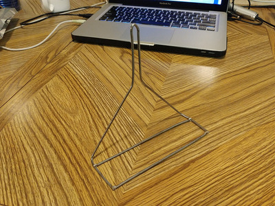

Reply 37 of 42, by xjas
Awesome job! Looks a hell of a lot more pro than the stand I made (I ended up buying one of these too. 😜 )
340.41 KiB
306 views
Yeah yeah... it 'works' though, as in, it holds the monitor off the table and doesn't tip over. (If I were Apple, could I charge $999 for this?)
I think the problem with the regular stands these come with is they're exactly the same as the 7", 16x9 version, but the extra depth of the 8" / 4x3 ones just makes them not fit well.

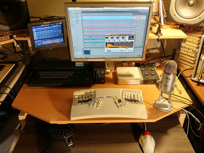

Mine is actually on my VESA arm thing right now. For a couple of reasons, I don't want to use two equally-sized monitors in this spot (doing that partly blocks the speakers, and means I'm always having to look to the left or right), but this works perfect as a little extra screen for whatever I need. Having HDMI AND VGA on it is supremely useful.
Do you have a link to the design file for that stand? I even managed to lose mine (for obvious reasons this is my go-to monitor for portable use), so a fitting stand that is actually useful too would be great 😀
