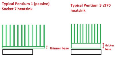

Reply 38 of 61, by Tetrium
To add to what's already been mentioned here, the older and more slow s5 and s7 Pentiums were very commonly fitted with the large passive heatsinks like the one pictured here
Thandor wrote:
A Pentium 75 is able to run without heatsink without crashing (although the intense heat doesn't do it good). With a big heatsink it wouldn't be a problem to run Pentiums without active cooling. In Compaq systems (fitted with Pentium 75 ~ 100) I found heatsinks like these (not actual picture, but similar). I'm sure these will run fine on a Pentium 133 as well.
These large passive Pentium 1 heatsinks were all over the place (often using heatsink latching clamps without holes so it was more difficult to remove them with a screwdriver) and many were that particular green color.
But these heatsinks typically have a much thinner base compared to s370 heatsinks, even though those older Pentium 1 heatsinks were fysically longer and wider. I tried to draw a quick & dirty pic to explain what I mean with this base.
88.56 KiB
1125 views
This thinner base will affect cooling I presume.
My retro rigs (old topic)
Report spammers here!
Reply 39 of 61, by gdjacobs
The heat sink has to be the right thickness to maximize heat conductance to the fins while maintaining small enough heat resistance from the base.
