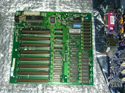

Hi, is anyone still interested?
I own this motherboard and I am trying to bring this back in life. There is a manual too, I can share more pics, just pm me.
Thanx!

Reply 17 of 21, by MMaximus
mtsiakiris wrote on 2023-01-08, 11:51:
Thanx!
Does yours work at 4.77Mhz speed? I used to own a similar board but never found the setting to disable the 10Mhz turbo mode.
Hard Disk Sounds
Reply 18 of 21, by mtsiakiris
MMaximus wrote on 2023-01-09, 19:22:
Yes, it works on both modes, it has a special pin that is connected to push-on / push-off button in front of the case.
Wait till I upload the full manual and may be that lead you to something similar in yours.
But, depending the bios chip, management chip and oscillator crystals on your board, it might be impossible for you to run on 4.77.
