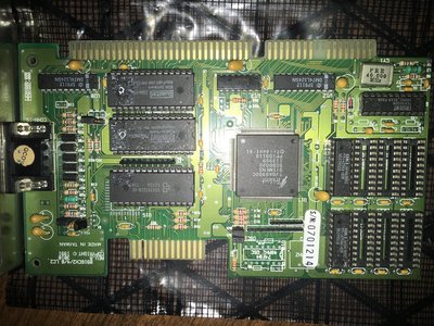

The Trident 8900c came today.
Unfortunately the seller put sticky tape on it and I couldn't get it all off.
Any idea on how I can remove that residue on the Quadtel chips?
Or should I just leave it?
I'm attaching a picture.
The card works, but not with the 386.
When jumpered to color, the 386 doesn't beep with the 8900c installed, but nothing is displayed on the monitor.
When jumpered to monochrome, the 386 has the continuous beep. Again nothing is displayed on the monitor.
We tried the 8900c in both the 16-bit slots and the 8-bit slots.
So it looks like this 386 board has other problems -- maybe one or more of the 72 memory chips.

Reply 22 of 30, by Anonymous Coward
There's nothing unusual about this board. All early 386 boards looked like that.

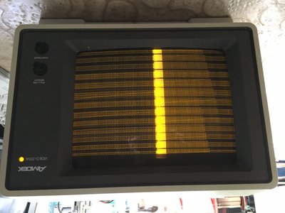

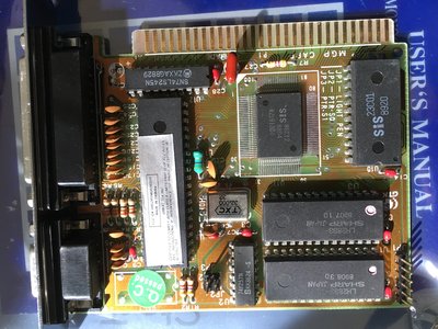

My brother located an old monochrome video card. Then he went crawling under the house and returned with an old monochrome monitor I that I don't think I've ever seen before. According to the manual, the jumpers on the video card are only related to the printer port memory addresses, not the video.
We didn't get a clear picture on the screen, but we did get something. The horizontal sync was off and couldn't be adjusted. The picture would shift every five seconds or so but never showed anything legible. We don't know if the problem is with the monitor or the card or the board. The PC speaker was sounding off the whole while we had it connected, so the 386 was still unhappy about something. We tried the video jumper on the 386 set to monochrome, color, and with no jumper, but the monochrome was the only mode that made any type of picture.
    2.88 MiB
    203 views
    Monochrome card
Reply 26 of 30, by Jo22
That monitor looks really cool! 😀
And that Hercules clone card looks also interesting!
Yes, mono cards do usually not require any configuration (except that mono switch on PC/XT mainboards or mono setting in the CMOS setup).
I assume the large chips at the end of the card are for the ~64KiB of RAM ? - I haven't ever seen such chips before.
And could that SIS 23C01 be an MGA Character Generator ?
This reminds be of something! I once had a similar issue when I made myself a custom cable for my Hercules compatible monitor.
Turned out I had mixed-up the pinout for h/v-sync (it later worked when I fixed that). But anyway, this was a problem caused by my clumsiness.. 😊
I guess you've got the original monitor cable and the issue is something else. Maybe you can test the monitor+card combo on another PC first to make
sure it's not the 386 mainboard that causes trouble (just an idea).

Nah, I meant the "new" issue with the Hercules monitor+Hercules card. 😀 There's a lot which can be going wrong, like timing.
His card is using a 32MHz xtal, while my card has a 16MHz one (doesn't have to be an issue, frequencies can be divided).
If the 386 mainboard is having trouble it could be an issue, too. For example, some 8bit card used the PC xtal for timing (not sure about this card).

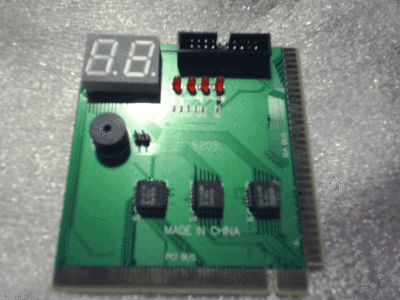

Edit: The most sensible would be to just use an POST card in this case.
Some models do also have a built-in PSU tester. This should clear up the mainboard issue once and for all.

Ah, ok, never mind. 😀 Skitters has got an AMI BIOS, so it shouldn't be too hard to find the right POST codes for it.
Even with a lifeless board I was a few times able to get at least some hex codes on such an diagnostics card.
Perhaps they can also assist to figure out at which point memory is getting bad (providing the BIOS in question perfoms such a check during POST).
They can be ordered from China for as little as $5.. It's no suggestion, though. I was just curious about current models. 😅

149.62 KiB
125 views
Here's my card. 😀
