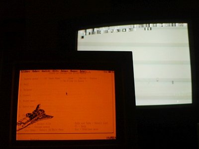

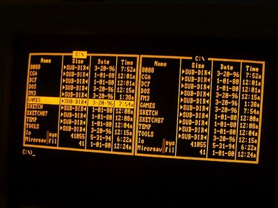

Reply 23 of 30, by Jo22
When I entered MODE MONO, the DOS console switched from CGA card to Hercules
(a frozen image was still shown on CGA):
10.42 KiB
880 views
MS-DOS Command Line Interpreter (CLI) on Hercules monitor.
75.84 KiB
880 views
Norton Commander v1.0x

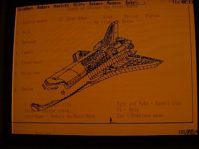

Afterwards, I ran my copy of Sketch which has built-in Hercules support.
To no surprise, it will mess-up CGA memory space, though.
I guess this is related to the fact that Sketch uses a lot of layers..
The text as seen in the picture is caused by a burn-in damage (not my fault):
34.26 KiB
880 views
Sketch on HGC (Full-Mode ?)
58.15 KiB
880 views

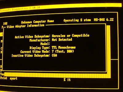

Next test, MSD. Microsoft Diagnostics detects the Hercules as a primary video device.
    70.45 KiB
    880 views

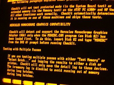

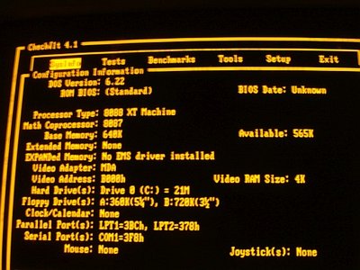

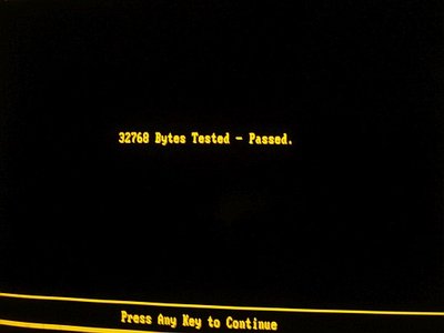

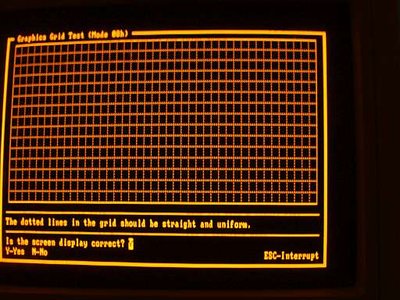

Checkit. When I ran CheckIt! first time, it detected no Hercules card, just an MDA.
It detected 4KiB of RAM.
    78.98 KiB
    880 views
    80.4 KiB
    880 views
Reply 26 of 30, by Jo22
Luckily, I remembered that in order for using Hercules cards, a TSR, MSHERC, was required..
So I executed it accordingly to the documentation.
107.85 KiB
880 views
When I ran CheckIt! second time, it detected the Hercules card.
It detected 64KiB of RAM.
83.14 KiB
880 views
84.42 KiB
880 views

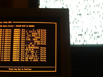

And gave an error message..
68.47 KiB
880 views

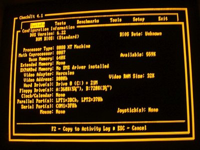

Reply 27 of 30, by Jo22
.. which I shortly after found the reason for.
Apparently, MSHERC runs in full-mode by default.
Running it with the more or less undocumented /HALF parameter fixed it for me:
25.69 KiB
875 views
42 KiB
875 views

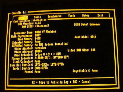

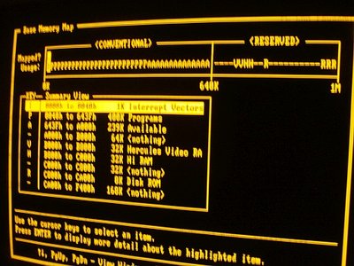

So when I ran CheckIt! a third time, it detected the Hercules card as intended.
It detected 32KiB of RAM.
84.29 KiB
875 views

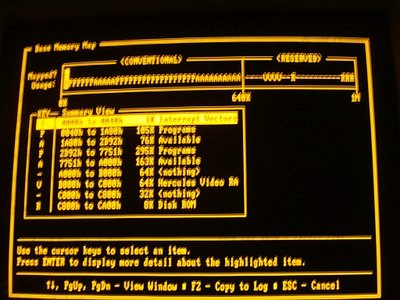

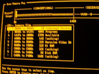

The memory map looks like this:
83.48 KiB
875 views

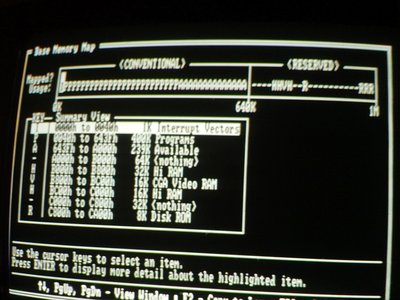

Reply 28 of 30, by Jo22
Here are two more pictures of the memory map.
First, the memory map as shown in Hercules mode..
222.68 KiB
874 views
CheckIt!, MODE MONO
..and second, in CGA mode:
198.32 KiB
874 views
CheckIt!, MODE CO80

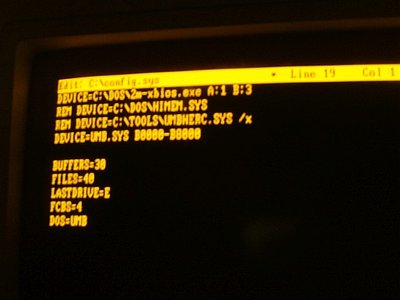

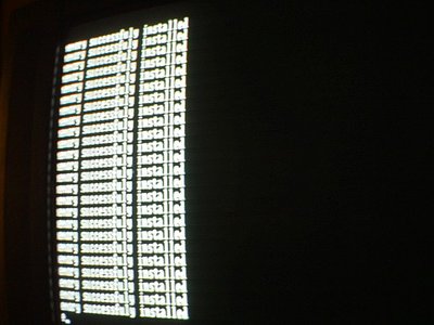

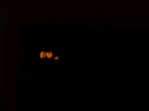

Okay, so I also tried umb.sys again.
No luck. 🙁
40.93 KiB
872 views
Norton Commander displays config.sys
53.81 KiB
872 views
umb.sys driver
Edit: I noticed a mistake of mine and fixed it (one "0" too much).
Unfortunately, it had no effect.
Edit: The same issue persists with all three cards I used last time.
Edit: I did a recording of the boot-up sequence and noticed an error message "Command line error !".
Probably caused by UMB.SYS: https://www.youtube.com/watch?v=yNg1paKXAIw
Does anybody know how to exactly use UMB.SYS ? 😕

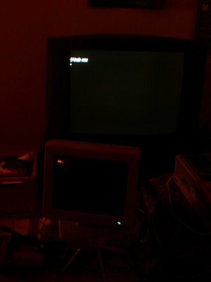

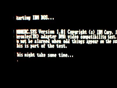

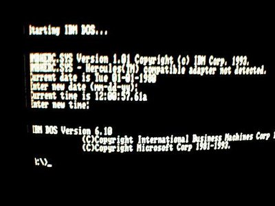

Reply 30 of 30, by Jo22
Things are getting weird.. Seriously. 😒
I gave IBM PC-DOS 6.1 a try, since it was mentioned along with umbherc.sys
at http://www.robvanderwoude.com/dosmem.php .
For some strange reson, the Winbond card was not detected as a Hercules card.
In a second test with MS-DOS 6.2 it was the same case, though, so it likely isn't related to PC-DOS.
Still, PC-DOS 6.1 didn't "fix" anything either when it comes to its own companion driver, umbherc.sys.
The other two cards, Epson Q205A and TD8088A were detected as beeing Hercules compatible, at least.
After waiting for 30 minutes anything to happen, I gave up.
My config.sys looks like this:
DEVICE=UMBHERC.SYS
DOS=UMB
No autoexec.bat.
    45.11 KiB
    845 views
    TD8088A, umbherc.sys on PC-DOS 6.1
    20.61 KiB
    845 views
    Winbond W86855AF, umbherc.sys on PC-DOS 6.1
