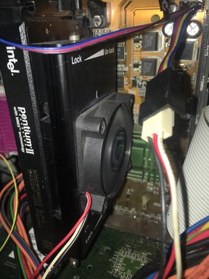

its a p2 266mhz / 66fsb
can i just unplug the fan? or will it run too hot?
the noise is driving me nuts:)

Reply 1 of 16, by gdjacobs
WD-40 isn't a lubricant. Options you can use include mineral oil (available at the pharmacy), sewing machine oil, and petroleum jelly.
Reply 2 of 16, by squareguy
Do not run it unplugged, it will become very, very hot.
Picture of heatsink/fan?
Intel SE440BX-2 Motherboard
Intel Pentium III 450 CPU
Micron 384MB SDRAM (3x128)
Windows 98 SE
Reply 3 of 16, by clueless1
Some fans don't have a good lube point. Be careful not to lube electronics, only cylinder/shaft areas. Like squareguy said, pics?
Reply 4 of 16, by kaputnik
Well, if the bearing is dried out, lubrication might help, depending of the bearing type.
Don't know specifically how those socket 1 fans are designed, but often the bearing is only covered by a sticker. Carefully peel the sticker off, and try to determine which kind of bearing it is. If it's not a ball bearing, put a drop or two of motor oil in the bearing, and replace the sticker. If you want, you can remove the circlip holding the rotor shaft in place, pull out the rotor, and clean the bearing surfaces before lubricating them. It'll be easier to determine the bearing type with the circlip and shaft out of the way too.
If it's a ball bearing, it's usually a ZZ (dust sealed) one. I've never seen open or half-open ball bearings in computer fans at least. You can get lubricant into those, by submerging the bearing in oil, heat it all up on the stove, and then set it aside to cool down. When heated up, the air trapped in the bearing expands and some of it escapes. When the remaining air trapped inside the bearing cools down and contracts again, the vacuum will suck in oil into the bearing.
Edit: if you don't know how to differentiate between a ball bearing and a sliding bearing, or only can see too small parts of it to determine, just go on the color. A ball bearing will be made of steel, a sliding bearing will most certainly be made of bronze.
If it's just you that's gotten used to modern low RPM CPU fans, no lubrication in the world will help.

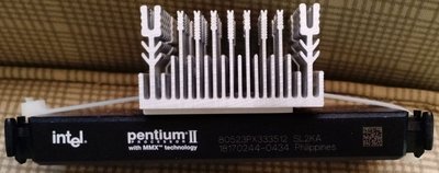

Reply 5 of 16, by konc
Without objecting to anything already said: There were indeed systems from respectable manufacturers sold with passive cooling up until the first PIIIs. And yes, not like today were there is some other fan blowing straight to the heatsink, just a common case with a huge CPU heatsink. I'm just letting this lie here although you did mention that you don't intend to buy anything...

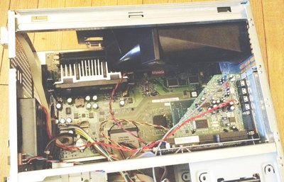

Reply 6 of 16, by clueless1
Here's my HP Vectra Pentium II 400. Admittedly, there's a ducted exhaust fan mounted over it.
969.15 KiB
1187 views

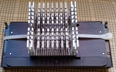

Reply 7 of 16, by kaputnik
Also got two socket 1 CPU:s with passive cooling, a PII 350 (SL356) and a PIII 550 (SL3F7). Used them both previously for quite some time, with just a 120mm intake case fan running at ~7 volts about 10 cm from the CPU, blowing towards it. No air ducts or anything like that. Worked just fine, the temperatures kept well within the comfortable range even under load, checked with an IR thermometer.

Reply 9 of 16, by Sedrosken
Indeed. Both my 500MHz PIII cards are passive, and I have a couple 600EB cards with passive heatsinks, although they're massive and probably meant to have a case fan running over them. AFAIK they all came from Dell systems. My 350MHz PII's are all passive as well, but I figured that was more normal. Those came out of other IBM PC300GLs.
heres a pic
PENTIUM II SL2K9
http://www.cpu-world.com/sspec/SL/SL2K9.html
    1.06 MiB
    1133 views
Reply 11 of 16, by clueless1
chrisNova777 wrote:
heres a pic […]
heres a pic
PENTIUM II SL2K9
You should be able to unscrew that fan from the heatsink, then follow these directions:
http://www.overclockers.com/em-spinning-lubricate-pc-fans/
Reply 12 of 16, by yawetaG
Depending on the kind of sealed ball bearing (rubber/teflon/etc. seals, clipped metal seals, or irremovable metal seals) , you can either pry the seals off with a needle or the tip of an X-acto knife or use a needle to carefully pry off the clips and remove the seals, then immerse the bearing itself in a cleaning agent (also when the metal seals can't be removed), take them out, let them dry, and relubricate with a drop of bearing oil. Reassemble the bearings with removable seals afterwards. No heating required.
Heating oil (too much) can change its chemical composition due to evaporation of components.
Reply 13 of 16, by yawetaG
clueless1 wrote:
chrisNova777 wrote:
heres a pic […]
heres a pic
PENTIUM II SL2K9
...and then replace the fan by one that's more quiet or attach a nice additional heatsink with lots of fins, because the model of heatsink on the processor tends to not do much without a fan.

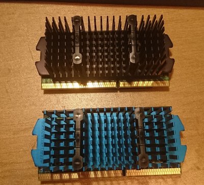

Reply 16 of 16, by PhilsComputerLab
That worked well for me also, especially for benchmarking.
I also have this CoolerMaster Slot 1 cooler that I use. You can easily replace the fan on it.
