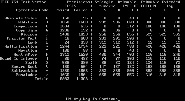

[EDIT] Wow, ran 'IEEETEST' in 86box and honestly I did not expect 14303 results to fail. So, even in 2023 what is used to emulate 387 FPU as code there is very inaccurate compared to a real hardware.
    8.81 KiB
    268 views
    86box IEEETEST results screenshot
This isn't exactly a solution perhaps, but Franke 387 was a good x87 emulator.
http://icfs.de/franke387.html
Some more x87 emulators to test:
Re: Coprocessors for the AMD 386DX 40MHz CPU
In the end, it's emulation, anyway. And it must be done by the CPU. 😉
Unless there's some weird FPU support integrated into the PC emulator.
DOSBox does this in its Win32 builds, I think.
It uses the x87 on the host side. Not sure if it requires the dynarec core, though.
Edit: Beware, there are several revisions of IEEE-754. The original is from 1985, but the International version is from 1989 (IEEE 754-1989)!
Which came out in the 80486 days pretty much.
Older 8087 and 80287 and 80387 FPUs can't comply with this release, maybe.
Another release came out in 2008 and 2019, also.
https://de.wikipedia.org/wiki/IEEE_754

In any way, it's a little bit shocking to me that for so many years, no one actually made an emulator anywhere closer to real Intel and/or Cyrix chips.
Those emulators were meant to allow people to use software that requires a coprocessor. I assume that a 100% exact emulation would have been a lot slower than one with less precision. So with an exact emulator such software would run in theory but probabaly be so slow that it would have been practically unusable.
Internally a x87 coprocessor uses 80 bit wide registers but hardly anyone really needs such a precision. My best guess would be that emulators limit calculation to 64 bit
Reply 27 of 29, by Deunan
Intel x87 are _a_ reference, not _the_ reference. Granted, on PC, where Intel was the assumed default, you'd want any competing design to be 100% compatible. But not because it's correct but because it causes less issues if every device gives the exact same result.
IIRC the IEEE-754 is not so exactly worded as to precisely define what should happen to the least significant bit in each and every case of ambiguity. And non-x86 FPUs often just do things differently like for example flushing denormals to zero rather than trying to recover all the possible bits of result. This is BTW an option also on modern x86 FPUs.
So, there are going to be some minor differences due to rounding or finite precision (like built-in lookup tables for trig functions, etc). A lot of these testing programs were written not to test vs IEEE-754, which might not even define some behaviour, but to "prove" that this or that particular math coprocessor is superior to other products. Some IIT chips for example were not fully IEEE compliant because they did not support reduced precision and ignored these control bits, always using all 80-bits. This is clearly not correct behaviour but also can't be called "less precise", and the chip was faster than Intel ones.
TL;DR: It's OK to label some chips as not fully (that is, 100%) Intel-compatible, in the sense of every bit of result being always the same in every scenario. But be careful when using words like "broken", "incorrect" or "inexact" - there are such cases, but mostly it's open for discussion what exactly is exact or not, Intel products included.
