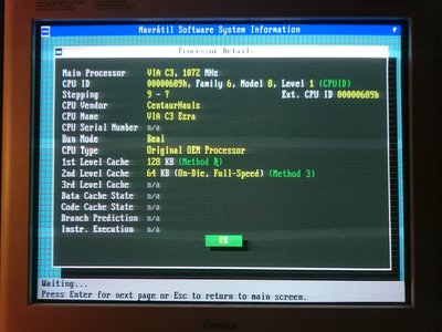

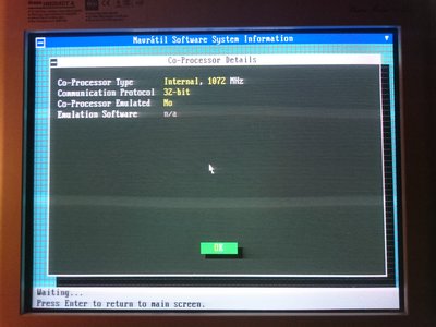

C3's FPU works only with half CPU Clock.

I have read that Nehemiah core introduced a full speed FPU. Normally one can do a benchmark comparison to verify such, but the preceding cores like Ezra are so peculiar...

You can see above that NSSI reports for an Ezra-T that both processor and co-processor (FPU) are running at the same speed of 1072 MHz (this is slightly off anyway, but the point being the same speed). The later Nehemiah should also be running the same. Even then, these FPUs are still fairly weak. Nehemiah being stronger than Ezra-T.
