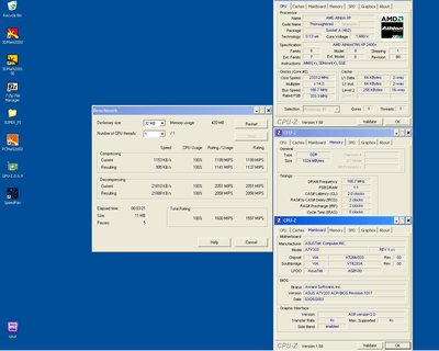

Thoroughbred B 2900+ (14 x 166 = 2333 MHz). 7-Zip 32M: 1597 MIPS

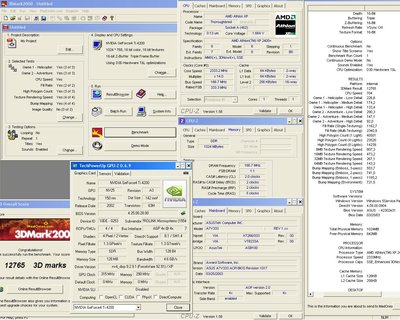

Thoroughbred B 2900+ (14 x 166 = 2333 MHz). 3dmark 2000: 3dmark score: 12765 CPU score: 704

What do you think? will the Barton 3000+ beat the Thoroughbred B "2900+"? 😁

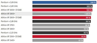

Interesting comparisons.
According to tests back in the day, we have seen that AMD has set the 3000+ (for the 166FSB version) too 'optimistic'. They have tried to release a counterpart to intel's 3.06GHz CPU.
More realistic rating for the barton would be the 2900+ ... 😊

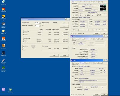

Barton 3000+ (13 x 166 = 2166 MHz). 7-Zip 32M: 1576 MIPS. Another loss.

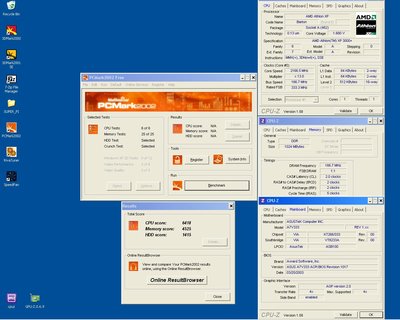

Barton 3000+ (13 x 166 = 2166 MHz). PCMark 2002: CPU Score: 6418 Memory Score: 4525. Mixed results, the Bartons 512KB cache does help when it comes to memory performance.

The conclusion must be that this two CPUs perform about the same and member melbar is right! The Barton Athlon XP 3000+ (FSB166) should have had a PR rating of 2900+ for the PR rating to be consistent with the PR rating of the Thoroughbred B Athlon XP with 166 MHz FSB.

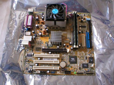

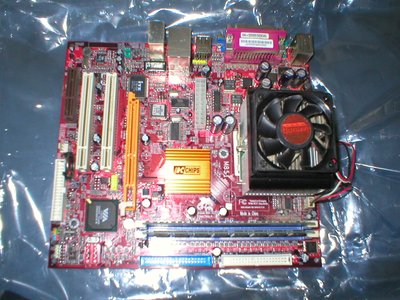

I really ought to do something with these at some point.

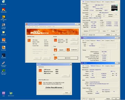

Barton 3200+ (14 x 166 = 2333 version).: PCMark 2002: CPU Score: 6851 Memory Score: 4694

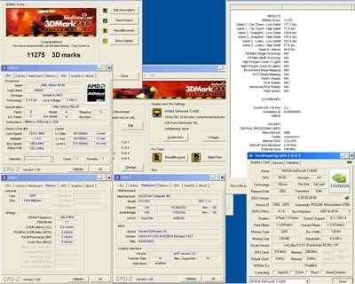

Barton 3200+ (14 x 166 = 2333 version). 3dmark 2001: 3dmark Score: 11275

A quick recap.
Super PI 1M
Thoroughbred B 2333 MHz : 52
Barton 2166 MHz: 53
Barton 2333 MHz: 51
7-Zip 32M
Thoroughbred B 2333 MHz : 1597
Barton 2166 MHz: 1576
Barton 2333 MHz: 1668
PCMark 2002
Thoroughbred B 2333 MHz : 6713/3954
Barton 2166 MHz: 6418/4525
Barton 2333 MHz: 6851/4694
3dmark 2000
Thoroughbred B 2333 MHz : 12765/704
Barton 2166 MHz: 13203/716
Barton 2333 MHz: 13757/731
3dmark 2001
Thoroughbred B 2333 MHz : 10802
Barton 2166 MHz: 10948
Barton 2333 MHz: 11275
The Barton is a fair bit faster clock for clock in comparison to the Thoroughbred.

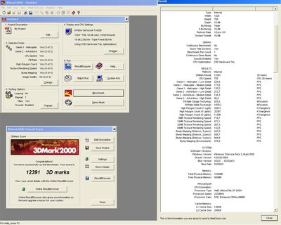

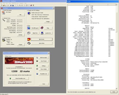

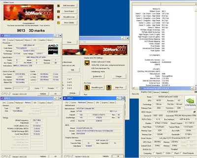

Today I did a quick AGP performance comparsion between the Asus A7V333 and the Asus A7V8X, basicly the same motherboard with VIA KT333 and VIA KT400.
The BIOS versions for both motherboards have pretty much exactly the same settings so it's easy to compare apples for apples. The only difference is that the A7V8X wont go lower than "tRAS 6" while I tested the A7V333 using "tRAS 5", this do not affect the performance in any measurable way. I'm using the GF4 Ti 4200 128MB @ stock, AGP subsystem performance differences should still affect the performance even if the system is bottlenecked by the video card.
I had to install the VIA AGP driver to persuade the A7V8X to not run the AGP @ PCI while the A7V333 is using what ever driver XP felt like using as it worked, I never install the VIA driver packages unless I have to.
Asus A7V333, Thoroughbred B 2333 MHz (2900+), Geforce 4 Ti 4200 @ stock: 3dmark 2000

Asus A7V8X, Thoroughbred B 2333 MHz (2900+), Geforce 4 Ti 4200 @ stock: 3dmark 2000

Asus A7V8X, Thoroughbred B 2333 MHz (2900+), Geforce 4 Ti 4200 @ stock: 3dmark 2001

Not much difference at all, the A7V333 KT333 motherboard is faster than the A7V8X KT400 motherboard but the difference is not worth mentioning.
