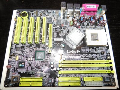

I have some of those motherboards but many of my boards have bad caps.

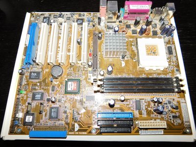

Another Asus A7V series board, this one uses VIA KT400 and I do not think I have tested it yet. This motherboard is also a dumpster find.
Asus A7V8X Gold-UAY rev 1.04 VIA KT400.

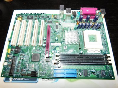

Here we have an Epox VIA KT400 board. I have no idea where I got it, it's probably a dumpster find.
Epox EP-8K9A7I VIA KT400.

Here is a motherboard I probably will not use as it needs a full recap. If it would have been a newer version I would probably have ordered caps right away but now I'm not sure this board would be any better than an Asus A7N8X. I will get caps for it some time in the future though when I need to order caps for some other motherboards. I have no clue where I got this motherboard but no one would throw a board like this in a dumpster?
DFI LanParty NFII Ultra REV_A Nvidia nForce2 Ultra (with bad caps).

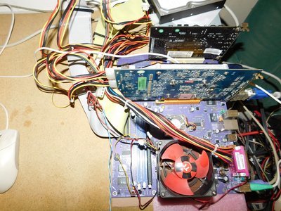

Reply 27 of 188, by Skyscraper

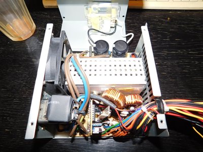

I'm making some progress.
Athlon XP systems mostly runs of the +5V rail, many modern PSUs have weak +5V rails. Digging through a pile of junk power supplies I found a 15+ year old Chieftec 350W PSU which seems decent. I don't remember the exact model name but I took a picture of the inside when I inspected the unit. The 12V line was kind of weak only capable of delivering 15 amps but it should be enough for a Radeon X1950 Pro 512.
The PSU

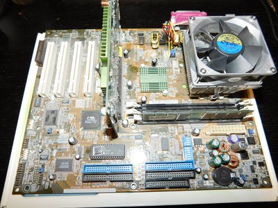

Don't you think it's a good idea to put a Radeon X1950 Pro 512 AGP card on an untested KT600 board with burn marks in one of the memory slots? Don't worry the X1950 Pro 512 is also untested and also has burn marks, on both it's molex jacks so it's fine! 😜
The system "assembled".
857.57 KiB
3062 views

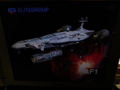

Smoke test! ...
And we have lift off! Literally, the CPU fan was set to 7000 rpm!

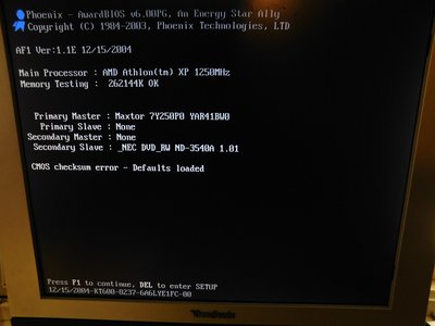

The POST screen.

Windows XP just finished installing. 😀
Reply 28 of 188, by kanecvr
... I wouldn't run a X1950 on a measly 350w psu... even the X800 series needs a 400w psu in conjuncture with a good CPU and some add-in cards. I'd say look for a 400 or 450w PSU for the x1950 and 3200+
Reply 29 of 188, by Skyscraper
I think it will be fine.
A PCI-E Radeon X1950 pro 256MB needs about 80W. I guess the 512MB AGP version could be a bit more power hungry but not much and it will take some small amount of power from the 3.3V and 5V rails. 12V x 15A = 180W, there will be about 100W left over on the 12V rail for the HDD, CD-ROM reader and CPU fan.
This PSU can deliver 30A on the 3.3V rail and 30A on the 5V rail which I think is more important, in any case I will notice if it dosn't work.

they say 80w, but my X1950 pulls up to 11A off the 12v molex connector - that's about 132-133w... that's coming pretty close to that theoretical 15A limit. The geforce 6800 has a similar power draw. Give it a go and see what happens. Even if you see magic smoke it should not damage anything but the PSU (in theory).

I'm not sure the motherboard designers from MSI that started working for ECS and designed the Photon boards were that good.
The ECS Photon AF1 is a board with some quirks so to say. If I disable the onboard bloat I don't need, lite network card and com ports I lose the Sound Blaster Live! aswell. Even if I disable the onboard devices before I insert the Soundblaster Live! it refuses to work. The only way to get the Live! working again is resetting the BIOS, and then just live with the extra clutter or disable all the extra crap in the Device Manager.
