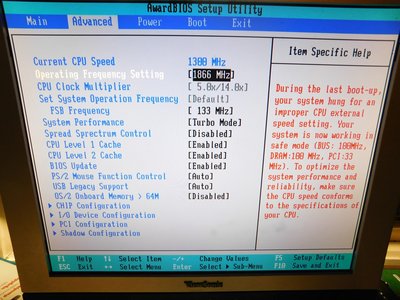

It turned out that I by mistake had installed an Athlon XP 3000+ AXDA3000DKV4E 10.5*200 (I didn't even remember I had this CPU) in the A7M266 instead of the unlocked AXDA3000DKV4D 13*166 I thought I had installed, thats why it was running at 10.5x.
The theory about why some CPUs* with multipliers greater than 12.5x do not post in the Asus A7M266 I wrote about on the last page will have to be revised as I decided to stop caring about what other people thinks! 😁
*Other than the Palomino 2100+, the Thunderbird 1300 and the Thunderbird 1400-100 which have remapped (12.5x = 13x, 5x=14x) multipliers. In fact even the Athlon 1333 and 1400(133) and late Thunderbird steppings in general have the 12.5x = 13x remapped multiplier. It seems the 5x to 14x multiplier can only be used if the CPU is modified to present it self as a genuine 14x100 1400 MHz Thunderbird. Otherwise the CPU will either fail to post when the 5x multiplier is chosen or post at the 13x multiplier even if the 5x to 14x remap should be present in the CPU stepping in question.
The first issue is common and easy to understand. Many old Socket A motherboards can not understand the "high (+8x)" multpler range as they lack the hardware to detect the state of the high/low multiplier range pin on the CPU. If a CPU is wired "high" it should/could still work at the correct speed if it wasn't for the second issue.
The second issue is related to the first issue and it's what causes what is known as the the 13x to 15x "multiplier hole" with Thoroughbred B CPUs that has a default FSB of 133 MHz. The issue is a chipset timing issue but" The Internet" do not seem to understand exactly what causes it.
The exact reason why the Thoroughbred B Athlon XP 2100+ (13x) to the 2400+ (15x) do not work in many older Socket A motherboards is debatable but here is my best guess. The thing making me doubt that I'm 100% correct are reports of some 100 MHz KT133 chipset motherboards also beeing affected while my explanation would only explain the issue with 133 MHz capable motherboards using chipsets like the KT133A and the AMD 760.

Update.
The Thoroughbred B 2100+ - 2400+ do not post in the Abit KG7 AMD 760 motherboard either.
Athlon XP-M (X*133) reports 800 MHz at first post in the Abit KG7 but it's to unstable to boot any OS at that speed so I'm not 100% sure what multiplier and FSB it actually uses at start up. The stability is only good enough to get into the BIOS and the BIOS does not show the current speed. If I do not set a valid multiplier and save the BIOS settings at first POST the CPU will not POST again until I reset the BIOS.
I have also found that Athlon XP multipliers are coded with 3x added to the Thunderbird multiplier value. This means that a 13x Athlon XP multiplier is in fact read by an old motherboard as (13 -(-8 + -3)) the same multiplier code as a 2x for a Thunderbird which isn't even a valid setting. This do not really expain why it seems the issue often can be fixed by changing the CPUs FSB ID from 133 MHz to 100 MHz though but it makes my threory above incomplete and opens up other possabilities.

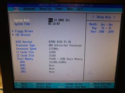

Here is a picture showing the CPU AXDA3000DKV4D running at 13 x 100 but the motherboard thinks it's a CPU with 13x -8 = 5x (or the 5x to 14x remap). The CPU is still at 100 MHz FSB just because this is the first POST with the new CPU and I have changed the FSB to 133 MHz but not yet restarted,
Asus A7M266 BIOS first POST with a Barton 3000+ AXDA3000DKV4D.
Asus A7V266 running at 13x multiplier and showing the correct speed but thinking it's running at the 14x multiplier.jpg

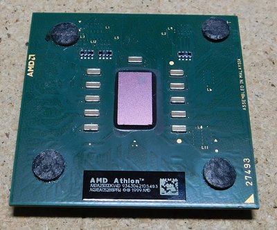

Here is a interesting CPU I found in my Socket A CPU box, a Barton XP 2500+ with a very very late date code. This CPU would probably be a good overclocker if it wasn't for the fact that it's "super locked" with an 11x multiplier. Perhaps it's worth to try to turn it into an Athlon XP-M later and then cut all L6 bridges to work around AMDs "super lock".
Barton 2500+ AQXEA year 2005 week 28.

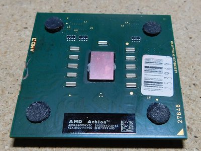

Here is another CPU with a very late date code, a Thoroughbred B made in Mars 2004. It seems the damages to the PCB has killed it. It's hard to see the smaller traces on the CPU in the picture but some of them are cut.
Thoroughbred B 2400+ KIXJB year 2004 week 11.

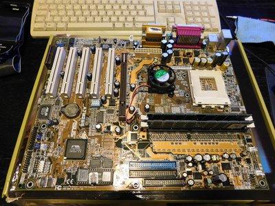

I have finished up my testing (for now) of the Asus A7M266 today so I can get back to benching, or at least back to trying to get the ECS Photon AF1 VIA KT600 motherboard to cooperate with the X1950 Pro.
Here is a picture of my beat up Asus A7M266. The board has a couple of somewhat dodgy caps in the CPU VRM circuit and the rest also seemed in need of some "reconditioning". When I first powered on the motherboard it was about as stable as a house of cards. After the motherboard had been powered on for an hour the screen stopped flimmering and the V-core stopped jumping up and down 0.1V. The board still only found the HDD or CD-drive every third POST and both one POST out of 10 but a BIOS flash solved that issue. I really hate these Mosel flash chips, they seem to degrade with time and can not be flashed with Uniflash.
I managed to install Windows and let the computer run the 7-zip bench for a couple of hours and after that the motherboard seemed totally stable, it still has many quirks though.
Asus A7M266 REV 1.04

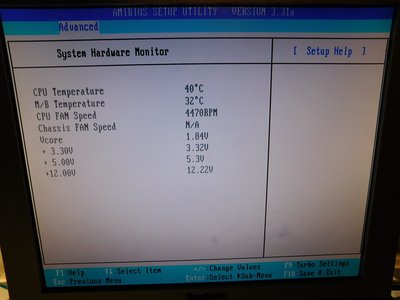

"Back then" overclockers seemed to prefer the Abit NF7-S v2.0 over the Abit AN7 as they often found them selves in conflict with the Asus uGuru hardware monitoring feature. My self I'm glad to be able to see what's going on in a world of old degraded caps! 😀

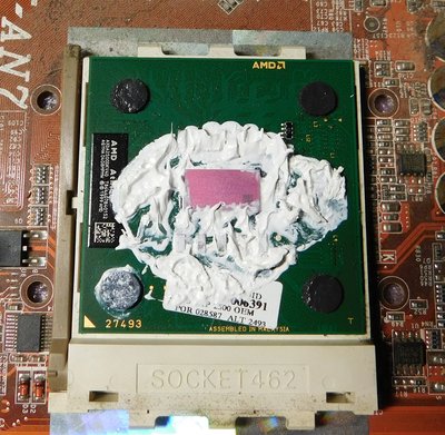

And finally! The typical Ebay sellers guide to applying Thermal Compound.
The CPU core is raised above the surrounding area, it will easily come in contact with the cooler so therefore it does not need any thermal paste. The core can in fact get damaged by the paste!
Spread ALL thermal compound in the tube around the core while making sure nothing ends up on the core it self. Should you manage to get any paste on the core by mistake then clean it off immediately!

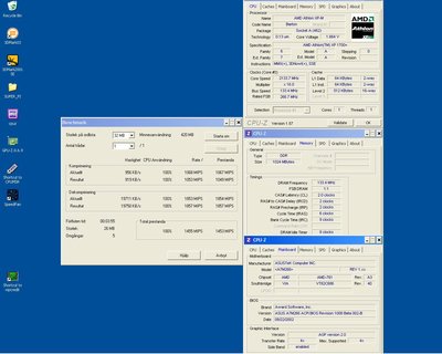

Here are some performance results with the Asus A7M266 AMD 760 chipset motherboard.
The CPU used is an unmodified Barton XP-M 2800+, the maximum "PowerNow! multiplier" this CPU can use is 16x. XP-M CPUs POSTs at the 11x multiplier in this motherboard.
I did not run an overclocked FSB other than a quick tests at 150 MHz, it seemed 2D stable but 3D-tests showed artifacts. I will test FSB overclocking with my other AMD 760 motherboard to see if this is a chipset limitation, if it's just the A7M266 or if it's the X1950 Pro which can not handle a 75 MHz AGP bus.
Barton XP-M 2800+ (16x133=2133 MHz): Super PI 1M

Barton XP-M 2800+ (16x133=2133 MHz): 7-Zip 32M

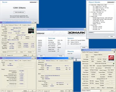

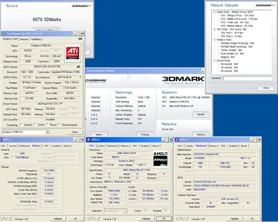

The 3D benchmarks are heavily bottlenecked by the AMD 760 chipsets memory speed at 133 MHz. The gain between 1466 MHz and 1866 MHz in 3dmark 2001 is only 1000 points.
3dmark can't even initialize the X1950 Pro with the CPU at the 15x or 16x multiplier. This do not seem to be a stability issue but an AGP timing issue and is probably unrelated to the stability issues I saw with the Catalyst 9.3 driver.
[edit]
Ignore these benchmarks, I found out whats needed to be done to make the AMD 760 chipset run much better in 3D and I switched to the faster (at least with the X1950 Pro) Catalyst 9.3 driver. I ran into exactly the same performance issues with the X1950 Pro running in an Abit KG7 AMD 760 motherboard and also the exact same issue with 3dmark even failing to initialize the card at speeds greater than 1866 MHz. This made me try some other video cards using PCI-E-AGP bridges like the Radeon X850XT, the Geforce 6600GT and the Geforce 7600GS, none of them ran at a decent speed and while the system was perfectly stable in 2D at 2133 MHz it wasn't even fully stable in 3D at 1866 MHz.
At that point I thought perhaps the AMD 760 chipset sucks will all cards using these PCI-E-AGP bridges and switched to a Geforce 6800GT but the instability got even worse, this made my tinker with the advanced settings. I knew Asus recommended changing "CPU skew" from a default 3 to 0 which I tried in the Asus board. With the Asus board I diddn't see any real difference going from the default skrew value to the recomennded "0" though, performance was still good in 2D but the 3D performance kind of sucked.
I tried to change the CPU skew to 0 with the Abit board but found this setting amazingly unstable. If going in one direction makes the issue worse perhaps the other direction makes it better I thought and tried the other extreme, setting 7. Suddenly the stability issues were gone and the 3D performance is what could be expected with both the Geforce 6800GT and the Radeon X1950 Pro and the initialization issue with 3dmark is gone.
There is still the issue with The X1950 Pro not running 3Dmark03 Battle Of Proxycon with the Catalyst 9.3 driver when the CPU is running at a speed over 2 GHz just like with the ECS KT600 motherboard. I have inspected the cards cooler and it's not filled with dust, I replaced the thermal paste. I have also added one fan blowing air on the cards power circuitry and another fan blowing air on the PCI-E AGP bridge but the issue remains the same. This seems to be an issue with the combination of this card and the Catalyst 9.3 driver.
The Catalyst 9.3 driver also still produces a more uneven frame rate in 3Dmark 2001 compared to the 7.10 driver though as the memory becomes an even more obvious bottle neck with better video card performance.
The conclusion is that these old motherboards with AMD 760 really needs a hands on approch with faster CPUs and settings I would have thought only could affect stability also affects 3D performance.

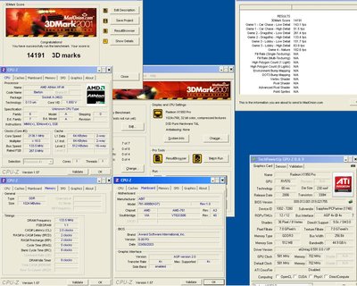

Barton XP-M 2500+ (14x133=1866 MHz) Radeon X1950 Pro 512 AGP Catalyst 7.10: 3dmark 2001.
IGNORE these results, I will rerun the benchmarks with this motherboard later. For now I will post the results with the Abit KG7 and I would think the Asus A7M266 will perform about the same.
