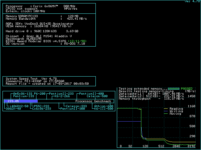

The MII-433GP arrived, so I immediately tested it. It runs at the advertised speed of 300 MHz. Runs also at 350MHz, even at just 2.0V. 😀 Strangely I have no settings to push it beyond that. At 350MHz and 1.9V the Quake benchmark exitted with en error near the end.
Cyrix MII-433GP 100MHz BUS 3.0x 2.2V; 85C M2433M100-22 1995-1998 VBSDD928AB […]
Cyrix MII-433GP
100MHz BUS 3.0x
2.2V; 85C
M2433M100-22
1995-1998
VBSDD928AB
DIR0=52 (ID) DIR1=35 (Step ID/Rev ID) DIR2=00 (Sub-Rev ID) DIR3=06 (Family Code) DIR4=01 (Model/Stepping) […]
DIR0=52 (ID)
Maximum multiplier setting = 3.5x, Minimum multiplier setting = 2.0x. ( I found some MIIs can be put at a 1.0x multiplier, but only on the P5A motherboard, not this one. And only when disabling caches. )
Benchmarks while running at 3.0x100=300MHz at 2.0Volt:
SpeedSys: 215,05 points
Quake1 _VGAtest (320x200): 53,4 FPS
Quake1 SVGAtest (640x480): 20,6 FPS
Benchmarks while running at 3.5x100=350MHz at 2.0Volt:
SpeedSys: 250,83 points
Quake1 _VGAtest (320x200): 60,2 FPS
Quake1 SVGAtest (640x480): 22,9 FPS
_VGAtest = Quake108.exe -nocdaudio -nosound -nojoy -stdvid +timedemo demo2
SVGAtest = Quake108.exe -nocdaudio -nosound -nojoy +vid_mode 12 +timedemo demo2

gerwin, if you look through the Excel sheet from the Ultimate 686 Benchmark Comparison (Excel sheet is now available in that thread), you can see which benchmarks did not fare well at 350 MHz. Specifically, it was Ziff-Davis Winbench96 CPUMark32, Ziff-Davis 3D Winbench97, and Final Reality. Everything else ran fine. Maybe you can run these in Win98SE after the chip has warmed up a bit to see if these will run?
I have not tried my MII-433 yet, so, I'm not sure if it can handle these tests at 350 MHz or not.
What graphics card were you using in those Quake SVGA benchmarks? At 350 Mhz, I scored only 17.8 fps. Used a Matrox G200, Quake v1.06, and timedemo demo1. Sound card was physicaly removed for these tests. Are you able to benchmark under similar test conditions? I know Quake 1.08 gives faster frame rates than Quake 1.06 shareware.
What does -stdvid and +vid_mode 12 do?

It will have to wait a little, currently I don't have time to install windows 98 etc. Also, I don't have a single Matrox graphics card really.
The previous test was at 2.0V. I can still raise 0.2V or maybe 0.3V if need be, so I think it should be able to run anything at 350MHz.
Quake with parameter -stdvid selects the 320x200 VGA mode. '+vid_mode 12' is Quake's mode number for VESA 640x480 8bpp, at least with Voodoo 3 and Nvidia. There is a list modes command in the Quake console: 'vid_describemodes'.

What I have found with testing Cyrix chips is that it is usually one specific feature which does not like to be overclocked by a certain amount. If your intended application does not make use, or does not make sufficient use, of this aspect of the CPU, then the overclock will work fine.
I noticed with the MII CPUs at 300 MHz or higher that increasing the voltage did not help at all.
