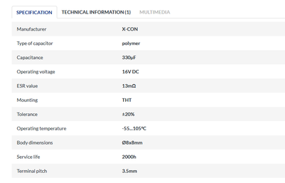

Reply 32 of 37, by Nemo1985
I was wondering if those caps will be ok to do a full recap of the board:
17.1 KiB
183 views
Is the ESR too high? The terminal pitch is right?
Thank you for any answer
Reply 33 of 37, by quicknick
I don't have the 5AX (had a non-working one, gave it away), but if the caps are the same 330uF/25V that Gigabyte loved to use on a few models during late 90s/early 00s, I replaced them on a couple of boards (7VX Slot A & 7VTXH+ Socket A) with Panasonic EEUFM1E331 electrolytics. These are 10mm in diameter, if the 5AX uses 8mm please disregard the above advice.
13mohm is a very good ESR value, doubt that the originals were anywhere near that if they weren't from a reputable brand and ultra-low-ESR series. If the diameter matches, the terminal pitch will match also.
Reply 34 of 37, by Nemo1985
Thank you very much for the tip, I have my gigabyte in a case, so I can't really see the dimension of the capacitors, I have to watch the internet pictures.
People before me switched down to 16v capacitors since 25v were probably used to achieve longer lifespan.
Do you think the panasonic will be better than the polymer caps I have chosen?
Reply 35 of 37, by quicknick
I kept the original caps from the GA-7VX, they are G-Luxon 330uF/25V and they still measure surprisingly good, around 27-30 mohm. The Panasonic FM of same ratings and 10mm diameter are 38 mohm according to the datasheet.
The 7VTXH+ was fitted with Choyo "brand" caps which were bloated so I threw them away. They measured 0...15uF and ESR was around 4-10 ohms.
The polymers that you linked above are obviously much better. I suggest taking out the board and measuring the diameter, it will be hard and unsightly to fit 3.5mm pitch caps in holes with 5mm spacing. Also, I think the board must be using at least a few caps of a different rating, perhaps near the CPU VRM. Both my Gigabyte boards use 1200uF/6.3V along with the 330/25 ones, and these I've replaced with Panasonic FR.
Edit: definitely (at least) two types/dimensions of capacitors are used on the 5AX, just looked at some pics.
Reply 36 of 37, by Nemo1985
Thank you, I watched the caps of the ss7 boards (asus p5a for example) and yes there are 2 different size of caps but still they have very same capacitance and voltage (v6.3 and 1000uf) there are just 2 that are a bit higher.
Anyway I will take the board out from the case, give it a look and report back.
Reply 37 of 37, by Nemo1985
I just checked, there are:
17 v25 330uf 3.5
8 v25 330uf 5
As supposed the capacitors have the same voltage and capacitance, the difference is the the dimension and the distance between holes.
This might be a problem because there is only one kind of polymer capacitors with 5mm and they are not cheap at all.
As a side note I was sure it used the G revision of the chipset, while it uses the E revision, so only the bugged asus p5a has the newest revision?
