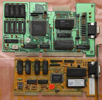

Reply 100 of 196, by Predator99
I think it unlikely you have 2 incombatible VGAs.
I did a quick look and found two 8900C. I am sure I also have a D but my collection is not organized very well...I will report later if it works.
EDIT: Both TVGA8900C dont work, but I didnt test them in another board before.
There is a long break at
1A 19
and post sequence ends at
30 24
No display on VGA.
EDIT2: Tried the ET4000 again, works. Exchanged against the TVGA again - also works now. Strange...
Indeed, both TVGA work now. Maybe the board didnt like the cold boot, 1st time I turned it on today.

Hmm seems to be something wrong with my Realtek but it works...
Came without RAM and I took one half from the Trident...
Afraid you need another explanation.
1.75 MiB
1773 views
1.73 MiB
1773 views
Also was interested and tried the "manual" VGA initialization, works!

Reply 110 of 196, by Deunan
Few more hours of tests and I know why the cards don't work. BIOS detects wrong video ROM checksum. It's wrong because all reads from 0xc0000-0xc5fff are OK, but at 0xc6000 and above it's a glichfest. The card ROM is 0x8000 long - so the upper 0x2000 bytes are gone. Unfortunately on Tridents there is some code in that area, not just fonts, so it has to be correct. I tried mod the card bios to pretend it's smaller and now it passes the checksum test but hangs, and I was not able to fully patch this code out.
So a mono card would work because it has no BIOS, and most EGAs have only 16k so would work as well. But I'm hoping the 8900C will work too, since it doesn't need ALE signal. I tried to soft-mod that signal out on the 8900D with capton tape but it doesn't seem to cure the problem. Also, this mobo is seriously picky about the card and slots - so far the Trident works only when jumpered to 8-bit and inserted into 8-bit slot (just like manual says, slot 1 or 7). Any other combination and I can't read anything form the card at all.
This is a really interesting problem, now I've patched out BIOS self-test and I'm modding that. But having to swap two chips every time is annoying, I wonder if getting an ISA Ethernet card with empty ROM socket would help here.

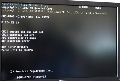

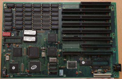

A monitor for port 80 writes would help as well. I haven't read all the source code but I suspect the emulator doesn't fully emulate the hardware, or makes some assumptions about it, and this works on AMI BIOS but AWARD perhaps does things differently enough to break things. It's to be expected, most of this stuff was reverse engineered by watching the original code execute. This is very time consuming and a lot of trial and error, and guesswork, is involved. There simply isn't anyone with free time to do it for AWARD BIOS.
Reply 117 of 196, by Deunan

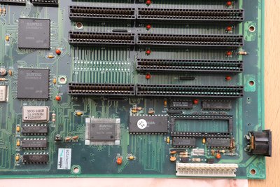

Another busy evening but the case is almost closed. I finally know what's wrong, so now I just have to fix it.
I put ATI Graphics Solution card into this mobo and it hanged the system with AWARD BIOS during video init. So I probed the pins and realized the card is never letting go of the I/O CH RDY signal, so basically it enters infinite wait state. It happened as the BIOS was trying read MDA memory at 0xb8000. I put a piece of capton tape over this contact and the BIOS goes futher but still no video output, and CGA does not have any ROM to init. It's all in the BIOS. So clearly the BIOS is not detecting the card at all.
After checking all the control signals again, the pull-ups and chip connection, it suddenly occured to me that RESET DRV is sort-of high (around 3V) and its active-high signal. So I shorted it to ground with a wire and... it all works now. The ATI card, the Tridents as well.
Long story short, B2 pin on ISA bus has broken connection to the '001 chip and is just floating. The voltage depends on what, if any, cards are in the slots. And apparently I somehow missed that pin when testing the ISA slot connections. Or maybe it's a microcrack and was still sort of conducting when I tested with the meter.
I still don't know where the copper has cracked but I'll look for it when I have a bit more free time, and there's a better light outside. Worst case scenario I can always add a wire, it's a not a signal that changes state except on actual mobo reset. Maybe all this info will help someone else fix their mobo.
UPDATE: Found the microcrack, right next to the ISA slots on one pin of a simple RF filter (wire through a ferrite core) that keeps this signal clean - as it goes all way around the mobo. I tried to make a photo but that just wasn't possible without a microscope with camera adapter. The crack would make/break contact as the mobo flexed - meter showed completly open and some 50 ohms depending how I tentioned the PCB. So it's possible it tested OK-ish when I checked the mobo by itself but went bad each time a card was inserted.

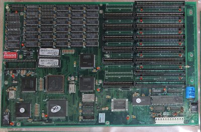

In the mean time I got another one. Looking at the corrosion I was thinking its never going to power on:
1.7 MiB
1604 views
Its Peacock branded, also with AMI Bios
Suntac Peacock.rar
1.75 MiB
98 downloads
After some cleaning...
1.74 MiB
1604 views
1.75 MiB
1604 views
....I gave it a try. And after replacing the keyboard controller and filling bank 0 with RAM it get as far as "20 1A" on the Post card! A message is displayed on the VGA:
CMOS INOPERATIONAL
SYSTEM HALTED
I assume its related to the mc146818, but the IC itself looks OK...
Reply 119 of 196, by Deunan
I will make a photo once I get new DRAM chips. There's been a shipping error so it'll take a while still. In the meantime I got a cheap 287-10 and it works fine - I've even back-ported my 386-only testing program to 286. Fun! Also I've discovered that NSSI will not run with 512kB system RAM, even though there's more free DOS memory than the minimum in the TXT file.
Still waiting for 2 more memory chips for the Trident C, I had 4 originally but one is cracked and dead. The card works with just 2 as 256k but I assume in 8-bit mode so is slower than it could be. Curiously the 8900D doesn't work still, it now tries to init (and sometimes the screen turns all blue) but hangs. So either I was right about the ALE signal after all or the BIOS requires 386 (unlikely?).
As for you new mobo, I can see A LOT of corrosion near the ISA slots, the '245, keyboard socket and the RTC. There's no way data signals D0-D7 are still working on this thing.
Considering the 008 chip state as well I'd say this is parts donor board at this point. I mean, it coudl be repaired, but is it really worth rewiring half the PCB?
