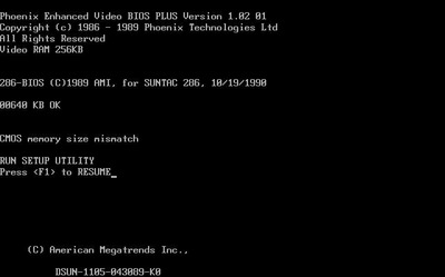

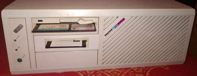

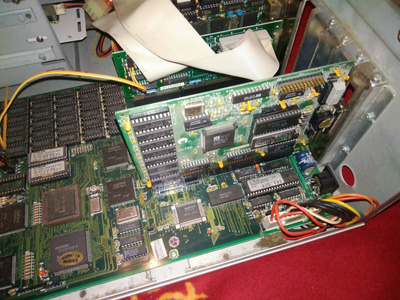

Reply 179 of 196, by Predator99
I have found an offer for a 286 PC at with a ST62 Board at local classifieds. In the screenshots I noticed the AMI BIOS is very new, 10/19/1990. I asked the seller and he was so friendly as to send a dump to me. I have tested it in PCem and added it here:
Re: 80286 BIOS image collection
