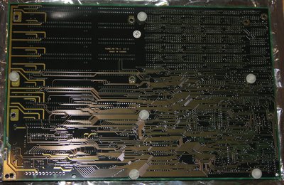

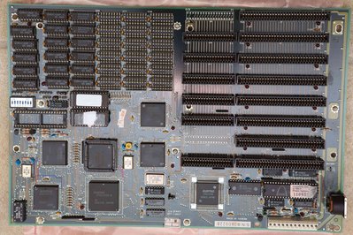

First a big thanks to MMaximus to send me this very nice (but not working) Suntac board!!! 😀
1.77 MiB
2225 views
1.54 MiB
2225 views
It is labeled "AMA-1240V1-D".
Bios is the Phoenix 3.10.22 as posted above.
As the board was not booting, I first tried the Supersoft ROMs. I tried 3 different CGAs, but no display. Beep codes are:
6-1 Cannot initialize monitor
6-2 ?
3-3 CMOS RAM
3-4 Floppy adapter
Everything seems to be OK, except the Monitor...! Had no success in removing all socketed ICs or playing with the Jumpers. Also tried other RAMs.

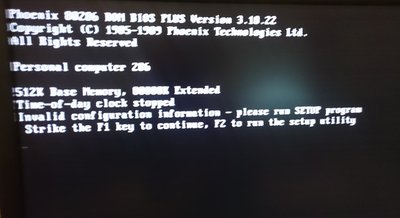

Then I tried again with the original Phoenix BIOS. Post sequence is:
00
01
02
03
04
05
06
08
09
0d
20
21
22
23
25
27
28
29
2c
2b (Screen memory test failure) / Beep: long short long short
2e
34
35
00
3A
38 (Memory high address line failure at 01000-0A000 (non-fatal) / Beep: short short
00
This indicates an error accessing/adressing the Video memory? Tried several VGAs, same result. To my surprise, the board is up after finishing the POST. I can switch the keyboard LEDs and a reboot with Ctrl-Alt-Del works.
No idea at the moment, no damage visible except some minor battery corrosion. All LEDs on the POST card are OK.
Will continue trying, but any idea is welcome 😉

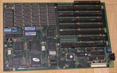

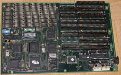

Reply 44 of 196, by Predator99
Did not manage to fix it so far...
But next one:
1.95 MiB
2291 views
After some cleaning it looks better:
1.44 MiB
2291 views
Seems to be alive, but the delay line in the bottom left is loose, almost all pins broken. Need a replacement...

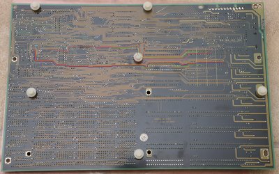

So I tested all Pins in the 8-bit ISA Slot 1 against Slot 8 - all connected.
But there is no conection of all adress lines to the ST62BC004. But no surprise: I followed some traces and some go the area around the CPU. So there cant be a direct connection to the ST62BC004...
EDIT: OK, tracked the adress lines as far as possible. Some end in the ST62BC002 the remaining in the St62BC003.
From a optical point of view all perfect, but will verify.
1.93 MiB
2211 views
1.91 MiB
2211 views

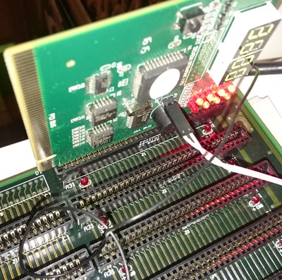

What also might be inteersting: The status of the LEDs on the Post-card: All lights on, except the IRDY, which is blinking during POST sequence and turns off at the end.
Therefore the Reset-LED is "on" all the time. Think this should not be correct. Even more strange that the board powers up in this status.
Reply 50 of 196, by Deunan
Oh, a clue! Do you have a reset switch connected? Try without it. And measure voltage across the pins you'd connect it to, it should be +5V.
Whatever the result, also measure pins 5 and 6 of the 4069 chip, and then 5 and 6 of the 7406. Both are next to 8042 keyboard controller chip.

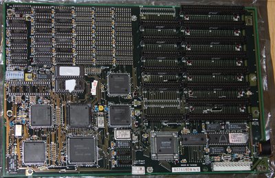

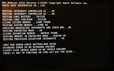

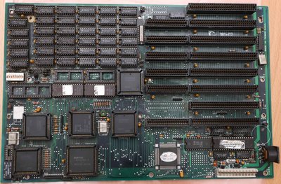

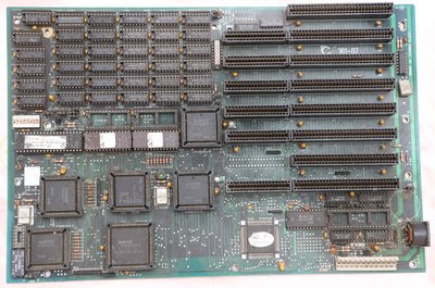

Next one: "Youth Keep Enterprise Co., Ltd." 301-02.
Was totally dirty. Removed all ICs and did a complete shower. But still working.
Before cleaning:
1.74 MiB
1929 views
After cleaning:
1.73 MiB
1929 views
Bios: 3.03YK2 Award
286-Suntac-Youth.rar
42.89 KiB
109 downloads
1.66 MiB
1929 views

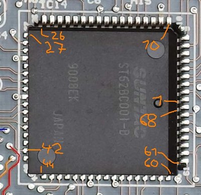

Reply 55 of 196, by Deunan
Somehow I missed your first reply. Anyway, the values look good so I wonder what is up with the LED. Just to make sure I did not misunderstand, the test card RESET LED is on at all times and even when the reset switch is connected and used it doesn't change the LED state?
Next round of tests then:
- Check if there is continuity between reset switch header (the pin that is not ground) and pin 42 of the 001 chip. This is mostly a sanity test but take a note of the resistance value, should be below 1 ohm or low ohms at worst.
- Check resistance between 001 pin 17 and +5V, you should be getting very close to 1k. Check the voltage on this pin when the systems runs, and when reset switch is pressed (you might need extra pair of hands for this).
- Check if there is continuity between 001 pin 17 and ISA slot pin B2.
The 001 chip is a bit weird in that the pin count starts in the middle, next to the dot, and then goes CCW. There are silkscreen numbers in the corners that should help you.
EDIT: Oh and I dunk dirty PCBs in water (with some dishwashing liquid) all the time, haven't had a problem yet - the important part is to make sure they dry out before reapplying power. Scrubbing them while wet with a nylon brush is also not a problem unless you get a PCB in such a sorry state that the soldermask is peeling off on it's own.

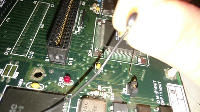

Reply 56 of 196, by Predator99
Thanks for your new advise 😀 See my results in bold below
Correct. Its on all the time. Also not blinking when pressing reset. However, when pressing reset POST sequence starts from beginning.
0,4 Ohm
0,997 kOhm
0,191 V when running
5,107 V when pressing reset
No.
185.45 KiB
1901 views
Btw, I had found datasheets for the 005 + 006, but not for the others...
ST62C006_GSTechnology.pdf
165.85 KiB
112 downloads
ST62C005-B_GSTechnology.pdf
451.51 KiB
94 downloads
Reply 57 of 196, by Deunan
Everything is OK then except this: No continuity between 001 pin 17 and ISA slot pin B2. Well that'a your problem right there. This might be interpreted by the video card as reset being asserted all the time so it's just not working.
This is sort of a global reset signal, generated by the 001 chip, it goes to other mainboard chips and should also go to ISA slots pin B2. You've already checked all the ISA slots against each other and found no broken connections (though you might want to retest B2 again now) so I wonder what happened to this signal. I suppose the only option is to try and track the copper trace.
First check continuity between other mobo chips. Now, the scan is a bit hazy so I'm not always able to tell the pin number, if you don't get a connection then try to sweep around the chip and see if there's a beep somewhere else. Pin 17 of 001 should go to:
- pin 40 of 003
- pin 19 of 005
- pin 53 of 002
- pin 92 of 006
The 1k pull-up on this signal is provided by "RA5" which should be a resistor pack below the 006 chip. Try to find which pin is it and solder a wire from there to one of the B2 pins (be extra careful not to mix the ISA slot sides!). Try booting with VGA card again. The point is it's still preferable to find the broken connection but first I'd like to check if that solves the actual problem or not.
Reply 58 of 196, by Predator99
Deunan you are the master!!! 😎
I noticed on the working board that the ISA reset pin is directly connected to pin 92 of the 006. And this connection was missing on the damaged board. But no chance to track the trace, the starting end ending points are hidden here.
As I have no soldering iron available here I made a quick&dirty fix with a wire and a needle. Power up..Reset LED is off...and works!!!!
Great!!! 😎 😎 😎
Many thanks to you, learned a lot again. And also many thanks to MMaximus for this board!
1.63 MiB
1869 views
1.64 MiB
1869 views
