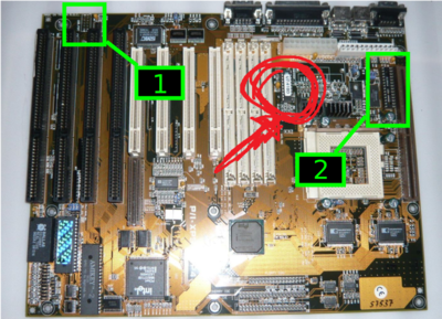

Hi all together,
i have a new Mainboard
ASUS P/I-XP55T2P4
Rev 1.3
U7 is missing, i dont know what this chip does or is needed for.
But i am searching for someone who can tell me how to get one of these (read old one, burn new one etc).
It would be nice if someone can help me out.
download/file.php?id=23091&mode=view
Thanks in advance
Stefan

Which one do you mean? The chip at [2] is TAG SRAM for additional cache (that goes in the slot beside), but I'm not sure what [1] is for.

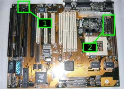

Reply 2 of 16, by Skyscraper
It's this one.
I hope someone else has a board with the chip so I do not have to find my board as I have no idea where it is and enough big boxes with motherboards to spend days searching...

Reply 4 of 16, by jackydany
Hi and thanks for the support.
I just received the board and havent tested yet. Although the last owner told me its not wiorking without, but its a nice board and it was cheap (4€) so i bought it "blind" 😁
Yes its the U7 socket marked in RED.
Have read about it, that its some sort of GAL, but i dont know and cant find any information anywhere.....
Depending on you guys 😁

Reply 6 of 16, by h-a-l-9000
Rank DOSBox Author
DOSBox Author
The little part of the logo does suspiciously look like Lattice, and the fact that it has a sticker is another hint - if it is indeed a GAL chip, you can't just buy a new one, it needs to be programmed too. The 'program' needs to be read from another board (this might also get hard).
