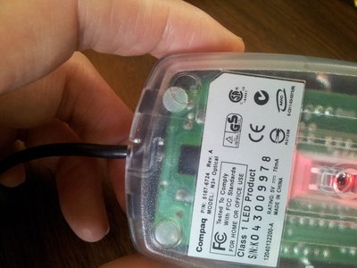

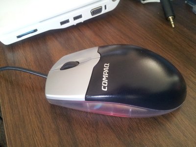

It's this one:
195.73 KiB
2605 views
183.47 KiB
2605 views
It's actually connected through a PS/2 KVM (the output cable from the KVM is connected to the PS/2->serial adapter on the DOS machine.) I just tried it directly connected & it doesn't seem to work that way. I suspect either the KVM is doing some signal buffering (likely) or translation (unlikely - specifically says in the manual that it doesn't support serial mice), or it's just providing the extra power that the optical mouse needs.
(EDIT: this was wrong - see below. It doesn't support serial mice for input but will output serial signals with a PS/2 mouse connected, essentially acting as a signal converter.)
You might be able to make one work with an adapter that taps a 5V line from somewhere to power the mouse? Not sure.
Reply 9 of 21, by Koltoroc
It is likely the KVM that converts the PS/2 to serial protocol. Those optical mice don't even have the serial protocol implemented AFAIK, because there is no point since the serial port can't power them.
Reply 10 of 21, by Anonymous Coward
That Compaq mouse looks suspiciously like a Logitech.

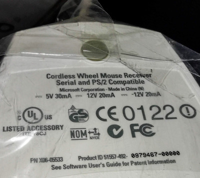

Actually, the serial port provides power but not enough for an optical mouse, which draws about 100 mA way higher than a regular serial mouse:
PC serial mouse uses typically DRT and RTS lines for generating +5V power for microcontroller circuit in the mouse. Because typical optomechanical mouse also needs power for 4 leds in the optocoupler movement detectors, there is not much power to waste. Typical PC mouse might can have the following power requirements: "+15V 4mA -15V 4mA" (taken from Microsoft mouse bottom).
This article is very interesting on how to draw more power from the serial port: https://www.epanorama.net/circuits/rspower.html
I have a wireless PS/2 mouse also serial compatible which draws about 70mA.
