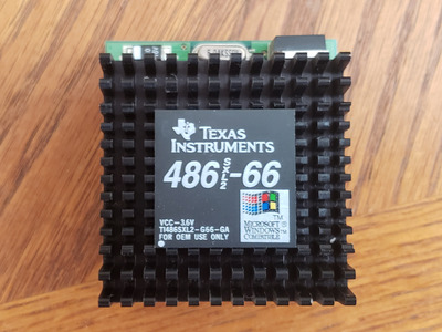

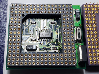

feipoa wrote on 2019-08-22, 22:06:
A CPU collector sent me some photos of another SXL2-66 upgrade, this time PGA-168 with VRM. This is what we're trying to replic […]
A CPU collector sent me some photos of another SXL2-66 upgrade, this time PGA-168 with VRM. This is what we're trying to replicate, minus the unnecessary extra circuitry. This adapter uses an EZ1086CM as the VRM. I have never seen one of these adapters in person or in photograph until now, so I suspect it is exceedingly rare.
Hey, I also have one of these! If this is exactly what we're trying to replicate, I'm willing to lend/ sell it if it may help someone produce 100 more 😛 Otherwise it'd probably just sit on my shelf. I'm afraid of using something so rare for a long term gaming build.

Hey, I also have one of these! If this is exactly what we're trying to replicate, I'm willing to lend/ sell it if it may help so […]
If that allows it to run on a standard board with (or even without) Cyrix support, I would buy a couple. I don't know any 486 boards that run the SXL2, and would love to test mine. Have a few PGA132 I would like to test as well.
Reply 170 of 955, by feipoa
Yup, that's it. Where did you find your upgrade? Are you willing to upload a photo of the top of the unit without the CPU installed? The bottom shows a NAND gate. There's also crystal, perhaps for the chip under the CPU? I don't think any of these are absolutely necessary.

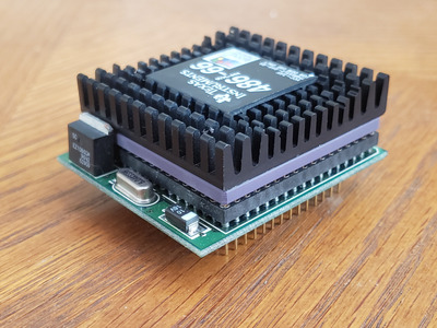

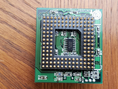

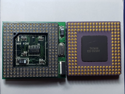

If the reproductions are like my example, they'll run on non-Cyrix boards. To answer both of you, I got mine attached to an early DTK 25mhz motherboard which was made well before the DLC chips. The seller (on Ebay) either wanted to get rid of it quickly or had no idea how rare these are 🤣. The SXL2 works on that board and a later 386 board I tried, though I haven't gotten around to extensive testing or benchmarks yet. However, it didn't fit onto my PCChips M326 b/c the CPU socket was too close to an ISA slot.
Photos coming up. Yeah not sure if the gates/ crystal are necessary, also note the empty "TC2" and "TC4" outlines on the bottom. I actually know a couple folks who I believe have PCB design experience, but they have their hands full and aren't crazy about retro tech. Either way, I'm definitely following this project and am interested in one, or two, or more interposers 🤣.
I'll PM you after I post my benchmarks; I'm doing another 386 build soon (parts in the mail) so that'll be a good time for some more testing before I let go of this thing. It would be interesting to see if this adapter works at 80 mhz or higher; we'd have potentially the fastest 386-class upgrade aside from the Transcomputer 486 module (unless there was a 100mhz Blue Lightning? I forgot) I would not be the one to overclock it though, I already fried a DLC-40 earlier this year at 50 mhz 😒

Reply 172 of 955, by NScaleTransitModels
