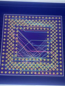

As far as Looking at this for a single pcb:
1.95 MiB
1238 views
There isn’t much room to run traces, heck the ground planes won’t even connect. Let alone be able to route all those nets. Also, I’m not sure how you would solder it with one pcb.
Sparing some kinda brilliant idea, looks like we gotta do pin headers. Or use a side by side pcb like Blavius made. (Which I understand is working well?)

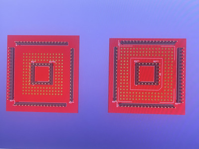

Reply 223 of 1211, by Sphere478
This is just a super sloppy sketch of what I am thinking.
1.89 MiB
1232 views
I believe this should be possible and relatively easy to assemble. A little complicated to route the traces though, but looks doable.
Four layer might be nice so we can keep the signals spaced out and put ground planes all over.
Smd mounting of the sockets is possible and would possibly allow a single pcb design but that would be quite a trick to solder.

Reply 224 of 1211, by feipoa
I suggest reading through this thread to get caught up on what we've already discussed. Otherwise, I will have to continually hunt down already present information and re-paste it again (as I've been doing).

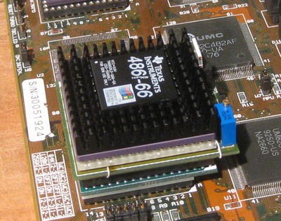

In regard to the two PCB's, here's a comment from one of the previous designers of the single-PCB interposer.
cb88 wrote on 2019-08-14, 19:36:
maxtherabbit wrote:
IMO tiido still has the right idea with 2 PCBs
yeah it might increase the board cost a little but that's easily worth it relative to having to deal with reflowing heinous SMD PGA sockets and pin headers. it would also make routing much easier
thanks for posting the kicad schematics and symbols - I might take a crack at it now
Nah thats nonsense... nobody else has ever done, EVER that for a reason. It's just more work... you'd always just use a 4-6 layer board instead. Reflowing the BGA packages is trivial... you should be able to do it with a hot plate or hot air gun relatively easily.
Also I do intend to continue with my design... it just isn't one of my priorities it's a hobby after all.

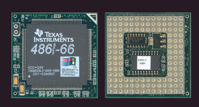

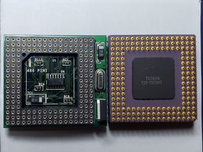

As discussed, on page 7, if you align the PGA-132 up against the PGA-168, you will see that there's really only two sides which may be more challenging to solder, but hot air and solder paste should negate most of that difficulty. The idea was to use single row pins rather than whole sockets to make hand soldering possible, however someone with the appropriate heating contraption may be able to use whole sockets.
139.07 KiB
1215 views
64.68 KiB
1215 views

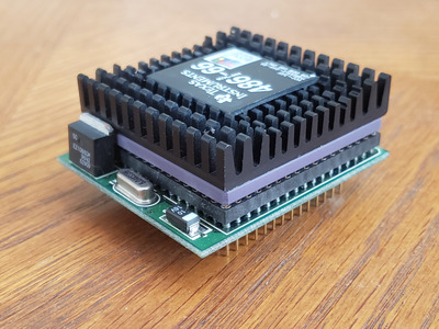

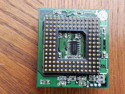

As shown previously on pages 8 and 9, here are the commercial product photos of what we are wanting to replicate. Unfortunately, these are so rare that it has eluded me thus far.
1.24 MiB
1215 views
1.46 MiB
1215 views
1.22 MiB
1215 views
If a 4-6 layer single-PCB board is beyond your desire, that's no problem, I'd be more than happy to test out a double-PCB prototype. However, if it fails at 80-100 MHz, I'd be left wondering, maybe a single PCB design would have worked.

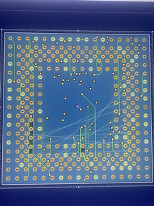

Reply 225 of 1211, by Sphere478
I kinda mentioned what you talked about, where a smd single pcb should be possible, I just feel that most people will have a lot of trouble assembling it I certainly would have trouble. But if you feel up to it, replicating the commercial product’s pcb (which appears to be smd) is of course possible.
Tryin to help man. Just brainstorming here. Saw the footprint upload and played with it a little in kicad in a free moment and typed some thoughts
On a single pcb through hole style, there isn’t much room between the pads for routing. With enough layers it may be possible though. Reducing the flood clearance does allow the flood through and routing a trace doesn’t generate a drc so. Perhaps one layer for x, one for y and two for xy (diagonal) for the signals. And two more for the power. So 6 layer.
I am playing with thru hole style stacked single pcb idea as I type this when I should be sleeping 🤣 it looks like 6 layer is possible. Gonna have to use quite a few vias to untangle it though.

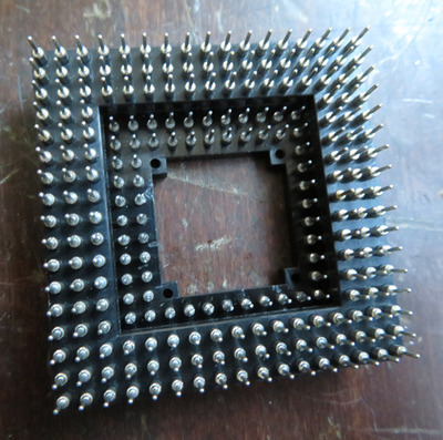

Reply 227 of 1211, by Blavius
Just a general question concerning the stack; where do you guys find SMD sockets and square pin arrays? All I find on eBay is tru-hole.

Reply 228 of 1211, by feipoa
Bravius:
I don't have any SMD PGA-168 sockets. My hope was to use through-hole sockets.

Still no promises, but if I get time what method do you want me to focus on first? Smd pads? Thru hole style? I gather you don’t like the pin header option? Fourth option?
I’ve kinda got a urge to see if I can route the thru hole method. 8 layer may be able to eliminate intermediate vias btw, thoughts on this? I think 6 layer is possible. 4 layer probably not.
6 layer will take up the center with many vias it seems though. So a center mounted vrm probably won’t happen.
I’d like to have mostly unobstructed power planes but if you feel that we can sacrifice here, 4 layer may become slightly more possible. Though I still think it will not only be a mess but a long shot at all. So 6 or 8 layer is my vote atm.
Which side gets the parts for the vrm btw. Do you have a preference?
Also are there any lines or pins that need switches? Like for multiplier or etc? Any tweaks that you want to add?

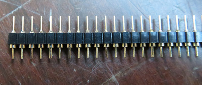

For assembly, I'd first try using rows of machine pins, as those shown above. Test the unit to ensure functionality at 80 MHz, then on a second PCB, see if I can use the proper PGA sockets w/hot air.

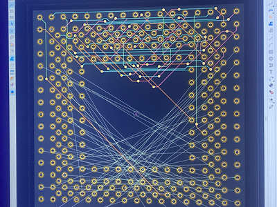

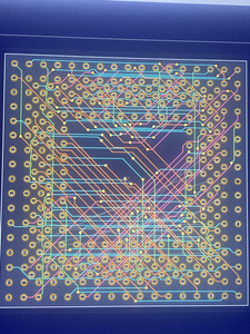

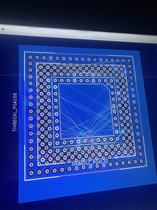

Reply 232 of 1211, by Sphere478
X, Y, XY, YX routing seems to work. (Barely)
Equal length might be a challenge.
Thoughts?
There are some DRC errors with the vias it seems, will have to look into that.
    1.67 MiB
    1130 views
Sphere's PCB projects.
Reply 233 of 1211, by maxtherabbit
if you can actually make it work with one PCB and two THT sockets, I don't think equal trace length will be terribly important
the distances will be so short overall as to not be relevant at these speeds
Reply 234 of 1211, by Sphere478
maxtherabbit wrote on 2022-09-12, 00:43:
I was kinda figuring as much.
First goal is to get them connected ….then go back and spend hours optimizing the routing 🤣
Finally, with 6 layers, x, y, xy, yx, gnd, vcc3. I gotta figure out where 5v is gonna go. (Unless you wanna power it externally, which I don’t imagine is ideal.

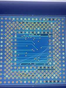

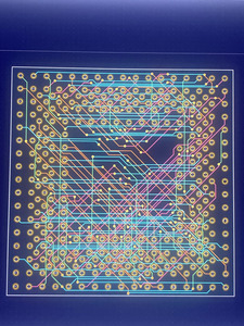

Reply 237 of 1211, by Sphere478
What a bowl of spaghetti haha.
1.71 MiB
1079 views
Still looking like I’ll be able to land all the non power signals on the four inner layers though.
Power is easy enough on the upper and lower. But 5v remains a question mark. Will have a clearer picture of what can be done once connections are landed. May end up using inner layers for gnd and outer for vcc3 and vcc5
Of course, once landed they need to be optimized (position tweaked, routing tweaked) which will take a very long time.
Taking a look at a inner layer, it looks like the plan for using each layer for only a specific direction of routing has allowed ground planes to propitiate. Which is what I was hoping for and should help signaling.

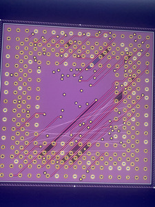

Reply 238 of 1211, by feipoa
Don't you want to include the overhang lip before optimising traces? I didn't see the overhang in those images, which would contain VRM, trimmer, 3-pin header, and maybe a tantalum, space permitting. VRM, trimmer, and 3-pin header would all be through-hole, while the caps and resistor SMD.
Reply 239 of 1211, by Sphere478
feipoa wrote on 2022-09-12, 07:21:
Haven’t gotten there yet. There is so much more work left, this isn’t even close to done.
Had to make sure that it was even possible to land all the connections on 4 inner layers.
And update: it is.
1.6 MiB
1061 views
The next thing I want to do is go through and tweak the routing of these traces.
I’m hoping between the four inner layers to have enough of a ground connection there to use it as a single stitched together gnd power plane.
Adding a overhang is easy, just gotta change the edge cuts. And tap into the power planes for the vrm.
Right now I have vcc5 on blue, vcc3 on red and gnd on all inner layers. These are floods so they go basically everywhere so long as there is a path from another part of the flood on that layer or a connection to a pad with that designation. On the top and bottom layers I should be able to extend the gnd plane to the center to act as a emi shield for signals passing through there. There should be enough around the pins/perimeter to carry the load. At least this is the current idea. Does this all seem okay so far?
