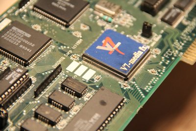

Just curious, you said you are going to repair it, so in which way is it broken? Or are you just doing a full recap just in case?

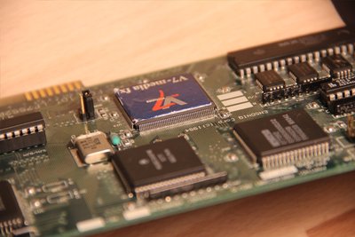

Well, I put in my 486 and installed the drivers, but it didn't get detected. Windows didn't detect it neiter did Warcraft 2 which I installed cause it has suppport for the card natively. Will do the recap and test again. There is also some weird sprinkeld stuff betwenn the one ensoniq and the motorola chip (you can see it on the pictures in the first post rather well) which I would check on next. I did some pocking with the multimeter and I couldn't find any shorts between the traces, but I will take a closer look at it when needed. I couldn't find a picture of my card with this stuff on it, so I guess it doesn't belong there.

I can't really tell from the picture you posted, but it looks like someone may have already tried to repair the board. The IC with the sticker on it (U13) seems to have a few leads that may not be soldered down very securely, particularly toward the top left corner. It looks like there is a different type of solder on a few leads (shinier). It may be worth poking very gently with electronics tweezers or even a toothpick to see if they are connected; they shouldn't flex much, and especially shouldn't move where they meet the board.
Reply 22 of 30, by Eleanor1967
You mean those on the third picture ? I tested all the ones which look bent, but they all make contact (tested with the multimeter).
Unrelated I even found some exposed cooper on the back side, this card wasn't handeld nicely before I got it.

To me, it seems like some leads on the IC are barely on their corresponding pads, and at least one on the left seems to be close enough to almost short to the neighbouring lead. Also, perhaps someone with electronics experience can chime in, but I've almost never seen a surface-mount capacitor with those solder blobs on its ends (like C16) make proper contact.
The other, less appealing, possibility is that the previous attempts to repair the board caused heat damage to the IC. The only way to know for sure would be to properly re-flow that IC and repair other trouble spots and try again. Perhaps contact the member who did the previous repair job for some tips, if he's still around.

Alright, some progress has been made. I didn't put in in the oven, instead I reflowed some of the funny looking spots again, removing some more excess solder, including removing the sprinkled stuff between ensoniq chip and the motorola chip (see photos for what I mean) and put the card back in the PC. I reinstalled the driver which fixed the freezing (well it froze once again, but it worked the other like 15 starts).
