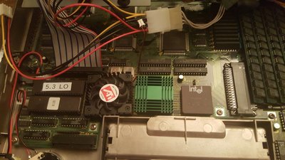

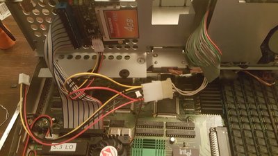

Reply 173 of 539, by Hamby
Vipersan, IanB,
Okay, I ground down the tit on the IDE cable, and in short, it now works.
When I booted, my choices in the bios were 100mb drive or no drive. But, after it rebooted, it said the drive was found at 1F-something.
I did a directory search of the 3 partitions, and they all showed up, then I played some commander keen.
(Since the sound and network drivers were for my desktop dos box cards which are different cards, I got errors about those, but I can deal with that later.)
I used a y-connector, 5.25 drive to two 3.5 drive power cables. One I used to power the CF card, the lack of which I think was what was causing my problems.
I have that gpu fan I pulled from an ATI video card; I was thinking of putting it (with thermal tape) on the chip to the left of the CPU. It comes to about the same height of the CPU if I put it there. But, 2 questions:
1) Will it do anything to improve cooling?
2) how do I connect its really thin red & black cables to the other 3.5 power cable to power it? Red to red, black to black, ignore the other black and yellow wires?
Vipersan, the keyboard enter key is still acting up. It seems to work when I hit it on the lower edge of the key.
How can I go about putting some contact cleaner in the key? Will I have to completely separate the keys from the circuit board?
Next stage of the adventure is to get the network card talking to the network, and then getting the sound card working (it's in the 8-bit slot). And then I can enjoy hell out of my laptop 😀

Reply 175 of 539, by IanB
Glad to hear you got it working.
The setting in the BIOS is ignored, XTIDE always detectes the drive capacity on startup.
That fan/heatsink is almost low enough profile to have been stuck directly to the CPU, it's just a couple of mm oversize.
Putting it next to the CPU like that might help as it will at least encourage air movement in the area and some air will be blown directly out of the right side and into the CPU heatsink so I think it's worth a try. The only way to be sure it's having an effect would be to measure the before and after temperature of the CPU heatsink after it's been run for a while with the cover plate and keyboard in place. If it makes a significant difference you might notice it just using your finger but otherwise you'll need to use something to measure the temperature.
The black cables on the 3.5 power are ground, the red is +5v and the yellow is +12v. The fan is probably +5v so just connect black to black and red to red and ignore the other black and yellow cables (make sure they are insulated so they don't touch anything). If the fan seems very slow or it's easy to stall then it's probably a 12v fan so connect the red of the fan to the yellow of the 3.5 power connector and leave the red on the power connector unused.

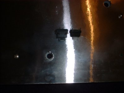

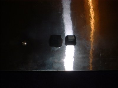

Reply 178 of 539, by Vipersan
OK ..
This will never be perfect ..but at least it will get my 5200 keyboard working ..
There are photos of the original ALPS key (white plunger) next to the ALPS ketswitch borrowed from the donor Dell KB ..
As you can see they are similar but there are dimensional differences ..
Sadly one of these differences is height ..
That said I could just have a couple of keys that ride higher ..OR ..I could change them all ..resulting in even height accross the board.
The actual contacts are roughly the same spacing although the originals had 2 extra legs to provide stability..
These extra legs are not needed for functionality.
To show this I have fitted one of the Dell key switches in the Toshiba keyboard pcb ...and fitted the Toshiba keycap ..
Which _does_ fit and isn't loose.
A bit of a hack job ..but hey ..
If it works ..why not.. and just means scrapping the dell keyboard..
No great loss ...and for the greater good.
Photos attached

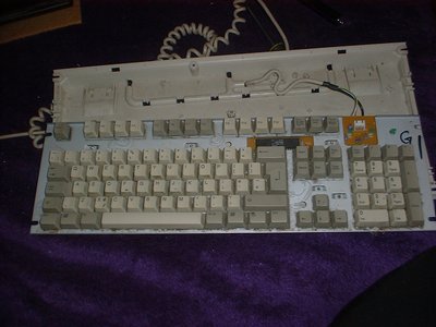

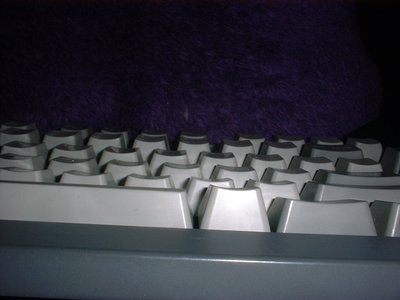

Reply 179 of 539, by Vipersan
More..
