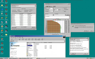

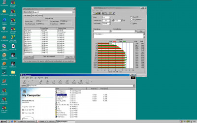

I have done some benchmarks with some tools that are available on https://www.philscomputerlab.com/hdd-benchmarks.html
Test results are in!
Disk full, no trim:
484.96 KiB
2873 views
Disk empty, pre trim:
484.41 KiB
2873 views
Disk empty, post trim:
562.93 KiB
2873 views
Facts!

That performance is terrible in general. Do you have DMA enabled? 😮

🤦 you are correct. I have just checked and it was in fact turned off... How could I miss that!? Must have been the time.
I'll post some new screenshots tonight.

As a sidestep: My tests, even though DMA was disabled, show that a full SSD could in fact impact the performance of the drive. I'm expecting enabling DMA on the SSD will show even clearer results. I'll just check that tonight to have definitive results and to at least have something useful to document here. 😆
