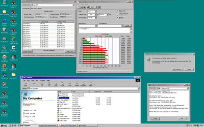

So, DMA obviously helped quite a bit.
With DMA, filesystem pretty full, no "trim":
260.3 KiB
1643 views
With DMA, filesystem emptied using Explorer, no "trim":
260.21 KiB
1643 views

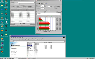

With DMA, filesystem emptied using Explorer, with "trim":
306.95 KiB
1643 views
In conclusion: Speed difference between a full drive and an empty drive is measurable but not noticeable in real world experience. When using the ForceTrim.exe application, there is no real difference in speed. It doesn't do anything useful for anything older than Windows 7.
