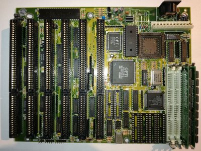

Ok guys, so i had this board arrive to me a few days ago. It was seriously corroded - thick and dark green stuff covered many of the traces and vias around the battery on both sides of the board. I decided to try and repair it, since it's my only 386SX board and because... why not?
I tested it as it was - of course it was completely dead. No beep, no codes on the POST card, nothing.
53.82 KiB
1292 views
(Photo from the seller. So small you couldn't see the extent of the damage. Or the bent pin on the 387SX 😠)

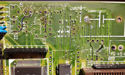

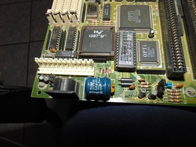

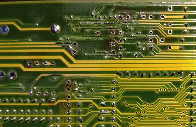

It took me a few hours to do the following:
-remove all components from affected area
-clean the board, (water/vinegar/isopropyl), use fine sandpaper to remove all corrosion and solder mask, use needle to clear the vias from gunk
-reinforce a grand total of 43 vias using legs cut from scrap ICs, bent and soldered on both sides
-reinforce all affected traces using solder, and thin copper wire where needed
-replace the components, using new diodes, resistors and capacitors. I had to reuse the transistors and inductors because i had no replacement for them.

After the attempted repair, and using the original (Award) bios, the board seems as dead as before. On very rare occasions the POST card displayed some codes (EC, C4, FA, FF) - but i got no beeps and no video initializations, and the FF code seems a bit nonsensical as it was displayed only once, right away at power on.
Searching the net i found another bios (AMI) for the 386SX / OPTi 82C291 / 82C206 combo. Burned this one on a fresh EPROM, and using this i get the following behaviour at each power on: POST card cycles through a few codes (04, 05 ... all the way to 13, and then 35 where it gets stuck). The thing is that it seems rather slow at this, it takes quite some time to get to code 35 (around 20 seconds, or 40 if i short the Turbo pins), so i left it for over an hour to see if it moves past 35, but it doesn't. According to the book, code 35 stands for Display mode set complete. BIOS ROM data area about to be checked.
Memory below 1MB calculated.
So, at this point i'm open to any new idea, as i'm out them...

Did you walk the repaired areas with your multimeter? (As in - put on some soothing music, poor yourself a drink, get a notepad, create a plan, and then walk it)
What voltage are you getting at the Vcc pin for the BIOS? Did you have leakage go under the CPU socket? Some of that trace repair looks like it goes right up to the edge.
Reply 6 of 10, by quicknick
@Deksor - although not many, there are some vias that do not cross fom one side to another, but to one of the inside layers. Five of them, under the BIOS socket, i've been able to trace and they have continuity. Of course it is still possible that another via, that doesn't show visible corrosion, might be broken.
@keropi, Anonymous Coward, noshutdown - i didnt know that cache is not so common on 386SX boards. Now that's an extra reason for me to keep trying 😀 . There are many similarities between my board and the ZIDA one below (mine just doesn't have the local bus connector and it's a tiny bit smaller, but the cache sockets and jumper settings are identical), and it seems the second tag ram socket is only needed when you have the full 128KB cache. My board came with three cache chips which i pulled out to have one less variable when troubleshooting (two W2464AK-25 and one MCM6264CP15 for tag ram, making for 16KB of cache if i'm not mistaken).
http://stason.org/TULARC/pc/motherboards/Z/ZI … OPTI-386SX.html
@CkRtech - checked all repaired tracks before powering the board, found and corrected a short between two adjacent ones. If by getting a notepad you are suggesting i need to go beyond the repaired areas (e.g. from origin to the end of each track) - you are right, but it might prove impossible. The board is packed with components and there are just too many vias under some of the chips and connectors and it's hard to follow each track.
The BIOS chip is getting the normal 5 volts, all of it's address lines have continuity to the address pins in the ISA bus and all data lines and OE pin have continuity to the corresponding pins of the two OPTi chips.
There was some small corrosion up to the edge of the NPU socket, and there might be some underneath it. But for now i don't have any tool to desolder it (but i guess the job can be made easier by cutting it in small pieces before 😁 )
