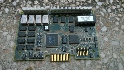

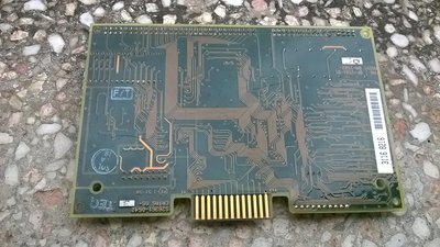

Yo guys. Anyone know for what computer this thing is?

Hello, good evening,
I'm speaking under correction, but..
The Zymos Poach 51 AA was a clone of the Trident TVGA 8800CS.
http://old.vgamuseum.info/benchmarks/606-zymo … oach-51-aa.html
As for the card itself, I believe it is a daughter card of some sort.
The edge connector could be a VESA/VGA feature connector,
while both of the gray connectors are ISA.
- This was pretty common in the 80s, I believe.
Some ISA cards had solder points above their ISA connector,
so another card could be mounted on them in a piggyback way.
Often I wished that people kept this idea.

Those edge connectors, looks like ISA slots in a different form.... Might be hackable to some degree, if you really want to fire it up.

Connectors looks the same as on this card
https://www.ebay.de/itm/Grafikkarte-fur-80286 … 3UAAOSwkrFajo4I
So the VGA connector is on the PINs on the top.
And the "ISA" connector...lloks like it would fit to the pin1 on a GUS classic...but there is a jumper block in between.

Hey, thanks for the link. So I my mind didn't play tricks on me when I saw that Paradise VGA daughter board once..
Maybe the GUS classic had such a piggyback header, too ? (I'm no GUS owner, sadly).
Stojke's card has 18+31 pins a 2 rows (36+62). That's 98 of overall pins.
According to Wikipedia, that's exact the same pin count as ISA has:
http://de.wikipedia.org/wiki/Industry_Standar … echnische_Daten
(German Wikipedia, since it has a table with specs)
