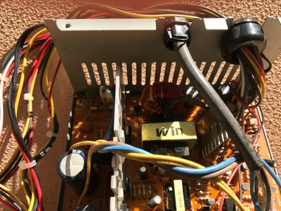

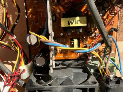

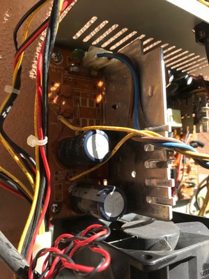

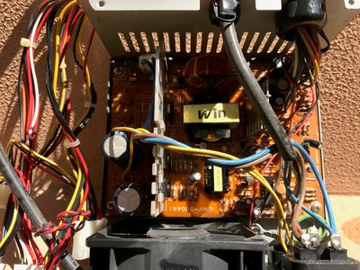

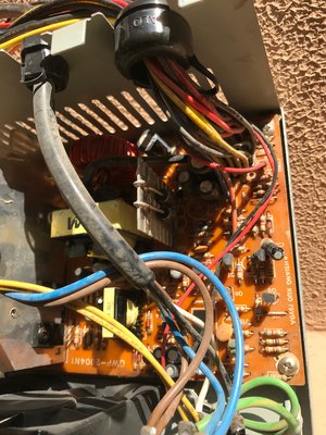

I bought a rather yellowed AT case lately, and while the front panel and interior has been hosed down in preparation for some retrobrighting, I thought I would also check the PSU out.
It was the single most filthy PSU I've ever seen.
So as much as I hate washing down any electronics, I had to hose it down as well.
The funny thing is, the psu's power cable to the power switch had been cut off. Why, I do not know. I am curious whether this was because they didn't want someone to accidentally turn the system on? Could it be something to do with a bad PSU? I can recrimp the PSU's connectors to the cable, but I am afraid it could blow something up?
I'd be glad if you can look at these photos and tell me if this PSU is worth salvaging and using. I have a spare brand new AT PSU but I would rather keep it as just that, a spare.

It is really low end, both power and construction. I would salvage the cables and heatsink, fuse and toss the rest. Those cables can be soldered into some ATX PSU to convert it to an AT thing.

That's some pretty severe cost down-itis. Coils on the pi filters? Y caps that are tested not to fail short? It's not like anyone needs FM radio, smooth DC output, or a house that doesn't burn down.

Pretty much the only thing which looks okay on this supply is the ground point.
Let me itemize the failure:
  • One PTC for transient suppression isn't enough.
  • Two plate capacitors for line filtration. This is insufficient and unsafe; what's installed doesn't form a bandpass filter and the caps should be safety rated X and Y type for this application.
  • Primary rectification? I can't see a FWB module or even a quad diode pack. Are they using half wave rectification here?
  • If so, that makes the switcher transistor complement a joke.
  • Good thing, though. The transformers on this supply are definitely not sized for a WIN. Nor are the primary caps. Nor are the heatsinks.
  • The secondary rectification! Why did they even bother with a heatsink here? It's not like there's a lot of thermal coupling.
  • Pi filters? We can't afford those. So what if the supply puts through massive amounts of ripple. We're making money.
Question is, did this supply come with a variety of meaningless power rating stickers so vendors can tune their lies for the customer?

Yeah, it was actually rated for 200W. 😵
OK, I've binned this PSU, I'll use my spare good AT PSU in this case.
