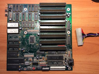

Greetings.
Can you please share ROMs contents of this board? Mine is basically the same (minus half 44256 slots), but with a strange BIOS (same sticker, but with v1.07 written by hand). Both halves that should be even/odd are almost identical, and I think that's why my board appears to be dead (no video, no beeps).
I've attached my ROM dumps, just in case, in raw and intel hex formats.

I have a quite similar one, but without HI/LO Bios. But you should be able to split my file. I had difficulties getting it running because of the weird RAM configuration, but now it works. Try the Supersoft-ROM for diagnosis 😉

Were the ST and the NEST produced side by side? And if so, does BIOS version on the ST correlate to the version number on the NEST? If so, and there were late BIOS releases for the ST but not for the NEST, it should be possible to split the ST ROM into even and odd banks for use on the NEST.

Thanks, but I already obtained one from Anonymous Coward. I even restored original one (1.07).

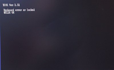

I have Juko XT replica. What kind of keyboard should I get ? AT or XT ?
Yep, I just fired up my Juko with an AT keyboard - it told me to go to hell (keyboard locked) - I'm not sure if the previous time I had one it was just a 101-key with an AT/XT switch or that it somehow autodetected what it was connected to, but yeah, a straight-up AT keyboard will not work.
