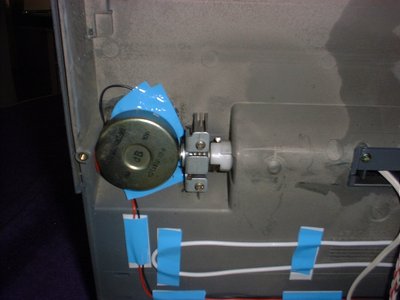

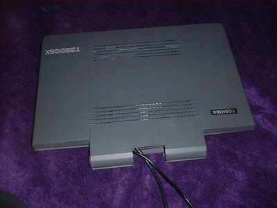

Reply 23 of 42, by Vipersan

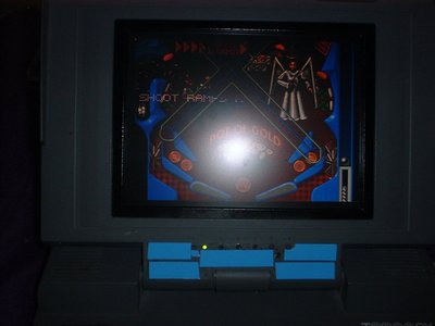

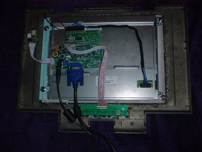

I decided to add my screen mods to this thread as well ...so decided to change the overall thread title.
We have a 5200 mods thread ..but the 3200 doesn't have one ..and so references aren't centralised.
Anyway..
managed to mount all of the electronics inside the plasma screen case...though it doesnt quite snap closed as yet ..
I think I'll have to either thin down the VGA connector I'm using ..make one of my own with no shell ,,,or hard wire it.
that said ..it is now pretty close.
I mounted the controls behind the glued down front plastic ..which is no longer useable on mine ..
The original T3200 owner butchered this ..and probably cracked the plasma screen at the same time.
Anyway ..the lcd screen controls can be accessed through a series of small hole I drilled ...and this also makes the indicator light visible.
Some pics of the build so far..

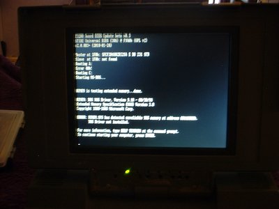

Reply 24 of 42, by Vipersan
So ..
The Sandisk Ultra II 4gb arrived ..and once again a 2048 partition created
(only the one partition) primary active ...and DOS6.22 installed ...
one again the T3200SX refused to boot C:
I have to therefore conclude in is _not_ the brand of CF used ..or speed of access.
This has to be a hardware issue ...or more likely a bios restriction...and may be fixable by our bios expert IanB.
But I cannot ask him on account he is MIA.
If I want to use a 4gb CF ..I guess I will have to go down the overlay software route...or stick with 2gb CF cards.

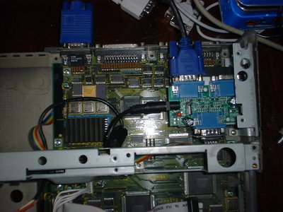

Reply 27 of 42, by Vipersan

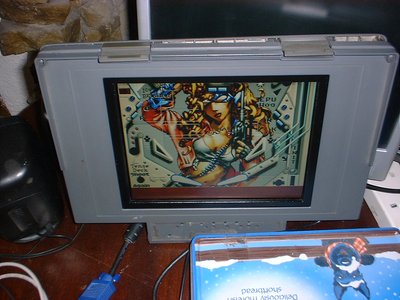

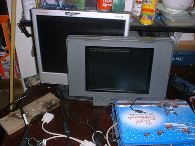

Made a start on splitting the VGA signal to drive the internally mounted VGA TFT ...and external monitor port..
I decided to use a dedicated active port splitter ..which cost very little from AliExpress ..
Removed the plastic case and physically mounted it under the psu ..
set back a little ..
The input to this device is drived by a 6 wire ribbon hooked directly to the pcb underside ...external vga port connector..
Effectively I could in theory drive 3 monitors now ..
I didn't like the idea of NOT using an active powered splitter ..as direct or passive splitting does degrade the signals..
It is powered internally from the T3200SX 12 volt rail ..
bit of a lash up at the moment and the 3200sx is only partly rebuilt atm.
The camera does show both monitors working ...but a very dull photo ...
it looks so much better in reality.
as I will show in a later photo.

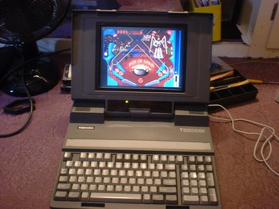

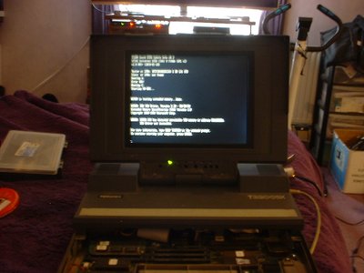

Not there yet but the prize is now in sight..
There have been unforseen issues ..such as ..
no space to mount the original T3200sx indicator LEDs ..but I can live without them.

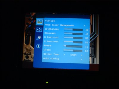

Had to make custom VGA leads to drive the screen ...but the vga splitter much improved the image..
A custom power 'loom' needed to be made to supply 12v and 5v ..tapped off the HD power plug ..
The display itself was also an issue ..since in came with Chinese as the default language...and NO manual ..so much prodding of the user buttons and several attempts and false starts ..
I finally got into English.
Occasionally I have to use 'auto' resolution detection ..and this is now easy ..on account I am reading English menus.
A simple button press usually fixes these resolution problems..
This is where I'm at currently..
(appologies for the cameras inability to focus on low light images)

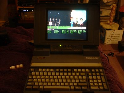

Reply 29 of 42, by Vipersan

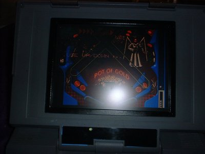

So ..I guess I am more or less done ..
Still got to re-install the sound card ..
but..
looking promising.
rgds
VS

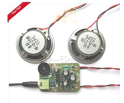

Anyway ..for about £3 ..I ordered this kit from China.
it runs on 5v ..which I already have spare on my custom wiring loom..
and gives about 3 watts of audio.
here is a picture of the kit.
the speakers are included and are exactly the right size for the vented upper case positions.
rgds

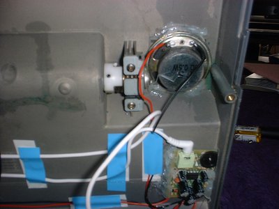

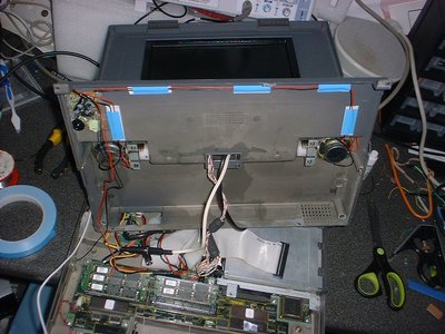

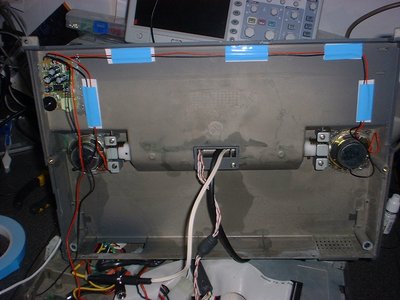

Reply 33 of 42, by Vipersan
So ..the audio amp kit arrived from China today ..
This is it partially installed ..
The amp pcb top left ..
The speakers placed at the vents ..
Top Left and Right ..
Still have to sort a supply out for it ..and route a lead through to the Line out of the sound card ..
A small slot was cut in the case on the left so the volume control edge wheel pot can be accessed..
Jobs for the weekend..🤣
As said it will never be hi fi or replace external speakers ..but should provide a useable alternative to the PC speaker ..and provide some portability..

Reply 34 of 42, by Vipersan
Job complete ..
reassembly later ..
Sure it wont be winning any prizes at a HiFi convention ...but is plenty loud enough and although lacking in Bass ..is very acceptable ..
I like it..

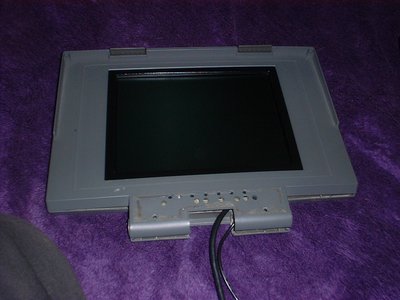

Reply 37 of 42, by Vipersan
So ..my new Gel front plastic has been created to cover the mess left after the original 'damaged' plastic was removed ..
using this method it is possible to use the TFT tactile buttons which will now be hidden under the surface of the new plastic..
see pics.
And no I have not fixed it in place yet as I may need to access the screen again before I'm finished...but the double sided tape is in place an simply needs peeling to finally fix it..
It will be the last job before I declare The modded T3200SX 'finished'

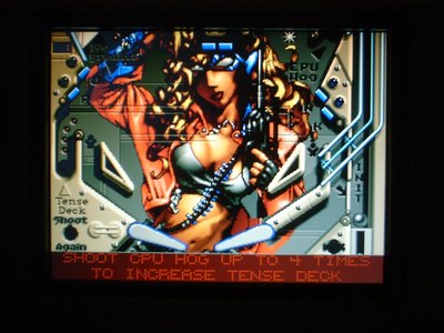

Reply 38 of 42, by Vipersan
Finally completed ..
My modded T3200sx ..
The final piece arrived this morning from the USA ..
another piece of 1mb IBM memory ..
actually I bought 4 simms ..as they were being sold in lots of 4 ..#
Now maxed at 6mb plus additional memory
& 386 cpu
So I now have a TFT screen T3200sx with original floppy drive ..running DOS from a CF card easily accessible in the unused modem port/hatch underneath ..
..and built in stereo audio ..with an ISA soundblaster.
Hope it meets with approval..
