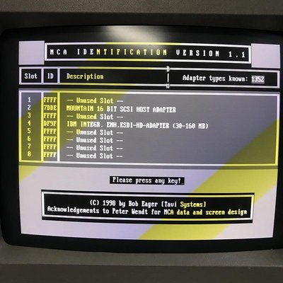

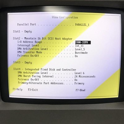

After this explanation I think I did the ADF installation correct as the card is being shown:
79.47 KiB
1197 views
and also used the program "MCA IDENTIFICATION" to show exactly what the SCSI card is and to find its ADF driver.
96.44 KiB
1197 views

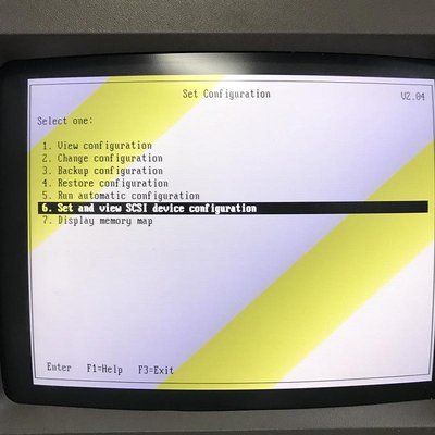

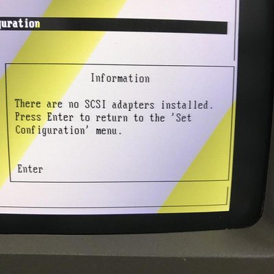

But why if I enter in the "Set and view SCSI device configuration" the card is not shown? is it normal?
74.46 KiB
1197 views
85.38 KiB
1197 views

Reply 3 of 19, by eisapc
The reason the adapter is not shown in the SCSI configuration is due to the fact the topic can only be used with IBM SCSI adapters. If I remember right even an Adaptec 1640 can not be configured under this topic. I am not sure if you will be able to run a HDD or even a flash drive from the Mountain adapter as it was originally designed as a tape controller and probably uses a reduced SCSI instruction set. Meanwhile its ard to find any of the PS/2 direct bus attached drives (DBA) for the 55sx, and even if, they are limited to 10 MB. The easies way is to boot DOS of a floppy and use interlnk and intersvr via a parallel cable to use the drive of a more standard computer.

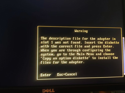

hello help me.. ibm 55sx... i replaced the battery from the cmos it keeps the time and date but it won't let me cinfigure the mca slots from the reference disk. it asks me to insert the related adfs.. the problem is that it doesn't even recognize the original hdd.. can you help me?

i have several ibm ps/2 i have several mca cards.. having said that i'm not new in this world!! but I can't understand why both with mca card and without it always asks me for adf.. even if I put the correct adfs it doesn't recognize them!! I replaced the dallas with a motorola nvram and modified to put the quartz. but the result does not change! I searched on the net but I can't find anything about my case. error 165 persists (lack of configuration) even if I proceed with the reference floppy.

To me it sounds like some corruption in the NVRAM.
Did you try to run the reference disk without any cards installed?
If the NVRAM is corrupted it may be necessary to configure the base system first, before adding any cards.
Are you sure you have the correct adf on your option disk?
qbmca from mcamafia.de can help to identify correct adf-file for the card.
